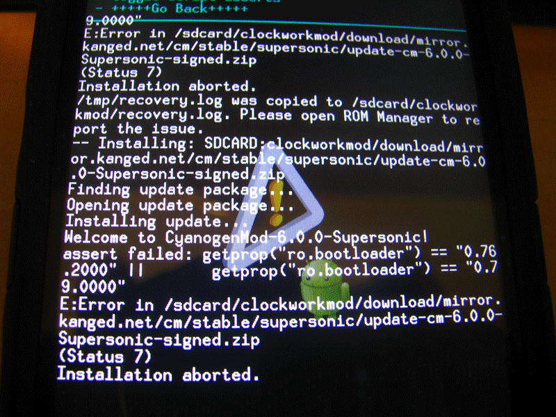

Root Trying to flash a Rom and got this..

attachment.php
What's going on? Take it easy, I'm new to this :p

I would also suggest not using rom manager to flash roms.
I would also suggest using aman-ra recovery.
just my preference... feel free to try or not :)
WARNING: After I change my HBOOT to the Engineering version so I could load CM6, too, my previously backed up ROMs wouldn't restore anymore (ClockworkMod Recovery v2.5.0.1).
Hopefully someone can explain why?
hmmm, i use ra 1.8.0 and had no issues before and after hboot change, but i went from .76 to .93 then back to .76
try flashing the hboot and recovery the backup was made in and restore.
