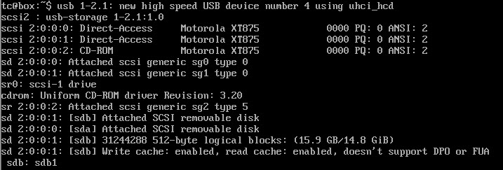

So now that my bionic is running JB, I headed over to the link provided in how to root.
Easy Root for Bionic running stock Jelly Bean
Loved Martys post and instrutions. He build a OVM file that can easily run in VMware workstation and provides a nice Linux OS with the root package scripts all set.
The steps are kind of Vague after you get the Linux console running.
" 5) Follow the instructions on the Linux console.
That should do it. If you need help I will be monitoring this thread."
Anyone able to provide more detail here? I have attach
