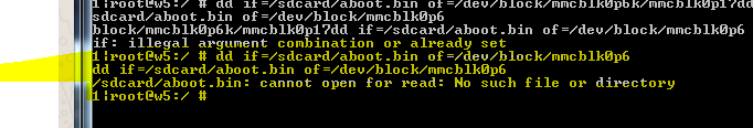

I could help with this error when installing the custom recovery
