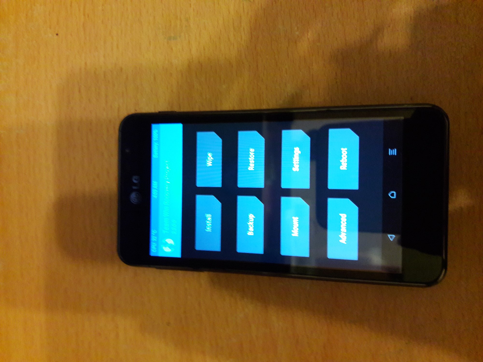

Hi guys, I am sk. I still keeping this phone p875. Sorry I might be too late to join as the phone is old. Recently, I ported twrp 3.3 to our device thanks to a porting guide "porting twrp without source" and loki tool from xda. It works fine.
PS: I am not a developer, just want to try something new. I treat this as learning
Here is the guide: https://forum.xda-developers.com/android/general/guide-porting-twrp-source-t3843473
Credits: Playfulgod - 2nd init recovery
Djrbliss - loki tool
TWRP
Some images of twrp

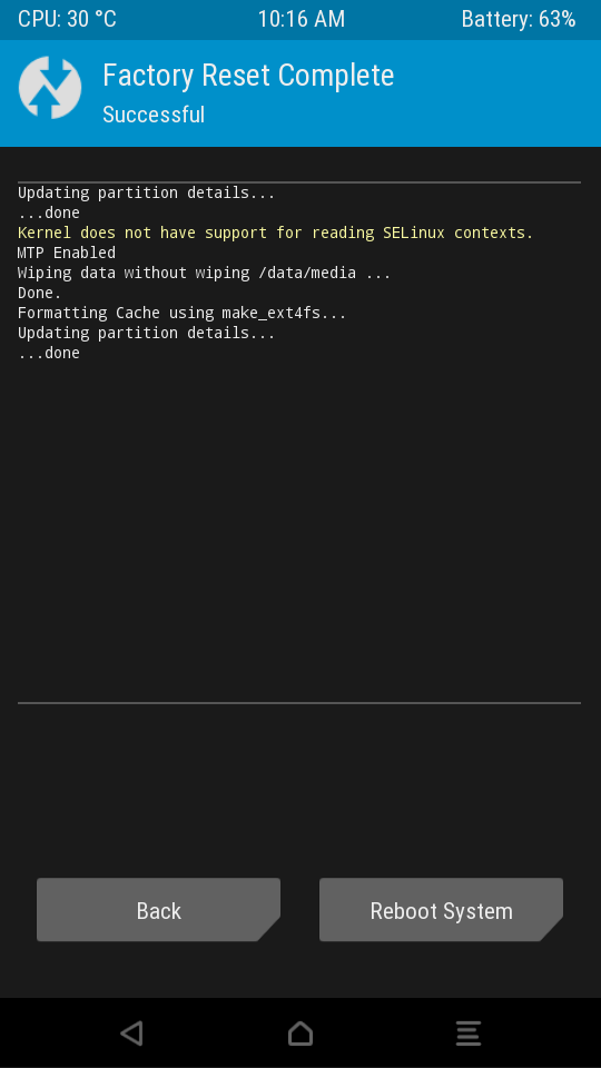

And so does Playfulgod too. I discovered my twrp will not wipe my internal storage when pressed wipe data/factory reset. The internal storage is mounted as /data/media. Moreover, our device runs jb 4.1.2 out of the box so tipatch app cannot be used. Anyway, thx for sharing it!
I see why you like Assayyedkitchen but I see its no longer in development. However, Im not familiar with LG's but I couldn't help but notice "kernel does not have support for SeLinux contents". Its not something I have come across when rooting, modding, or porting Samsungs. I certainly don't want to give advice on something I dont know, just hoping to help.

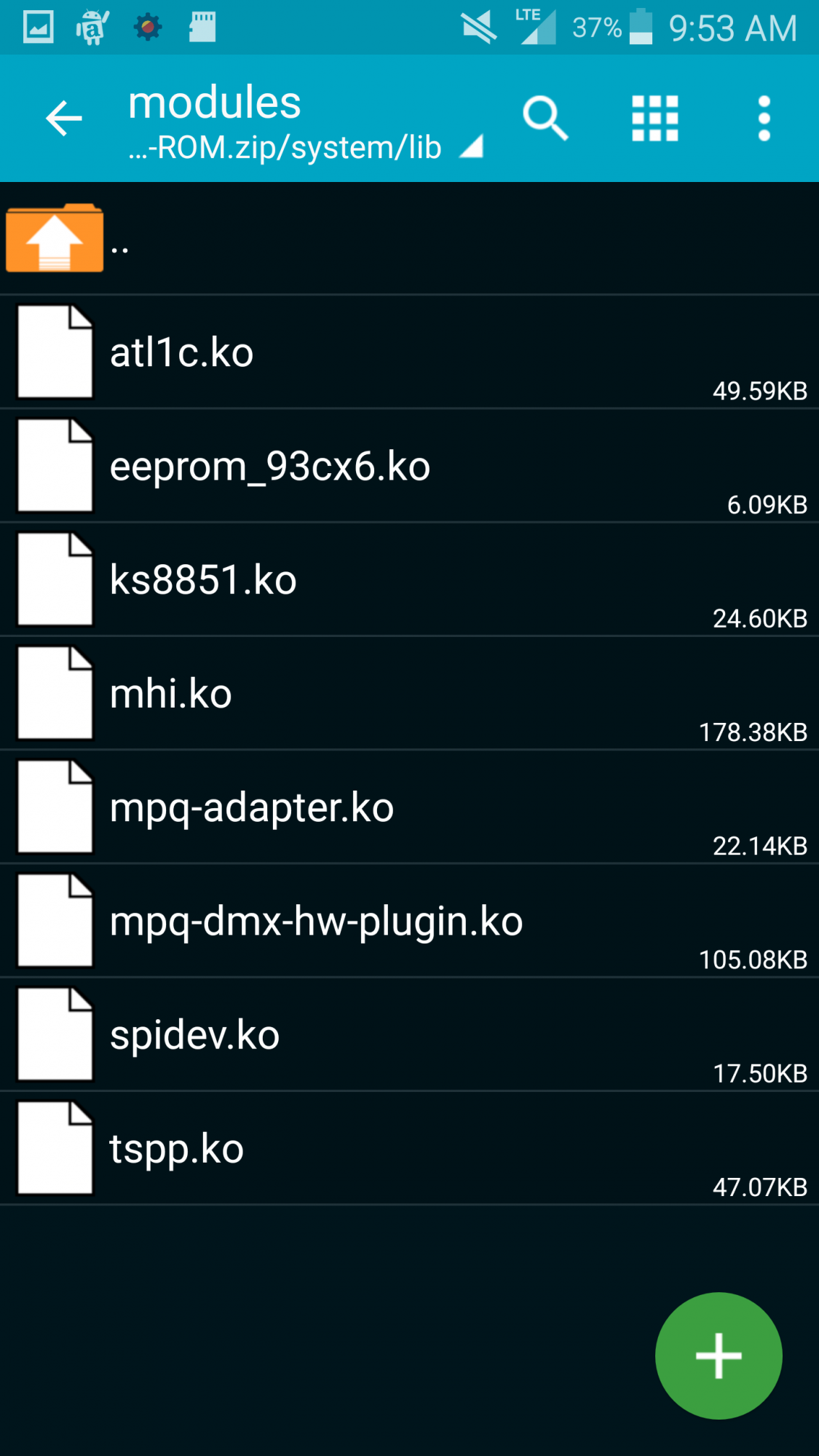

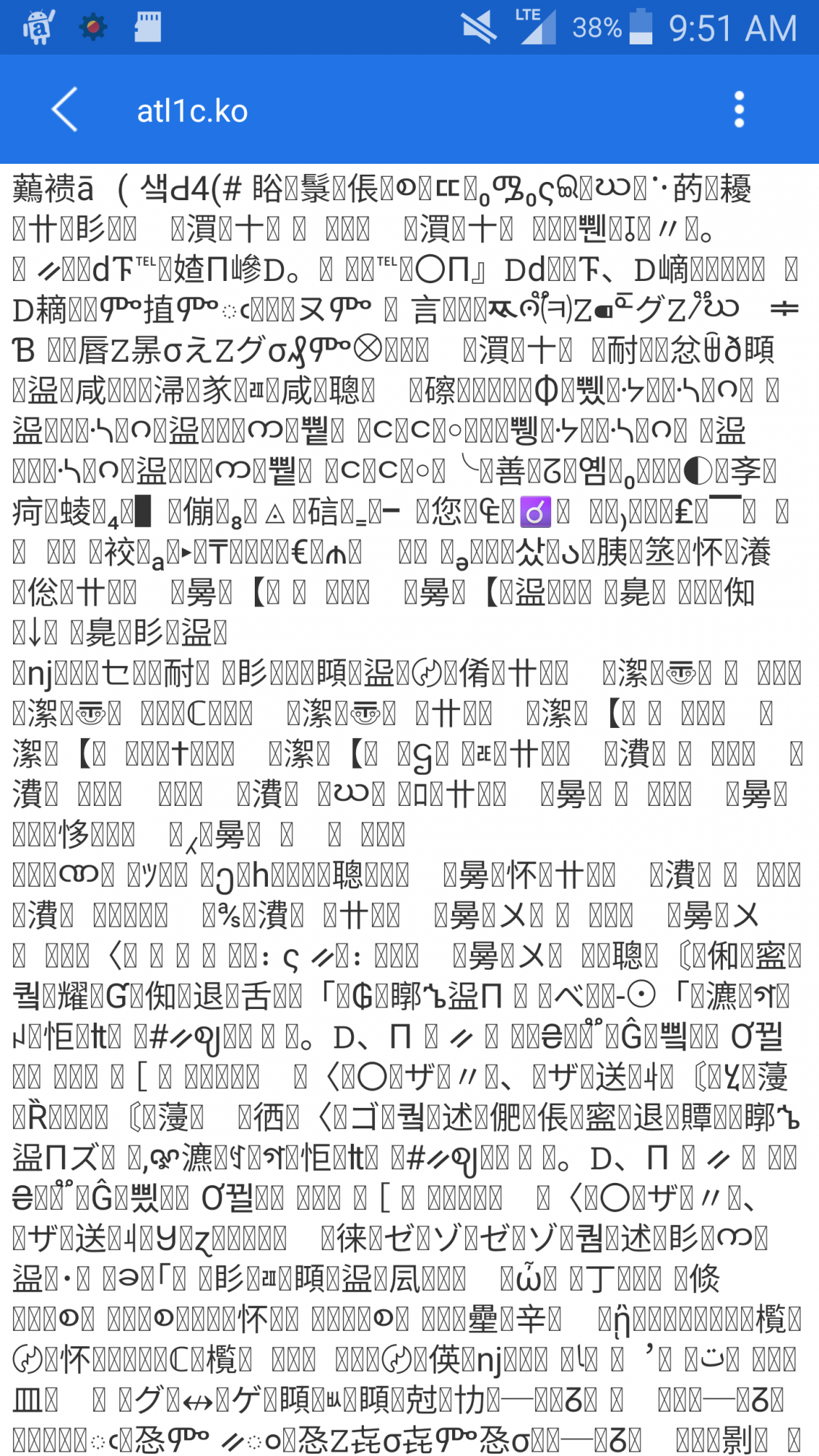

Looking threw the kernels, I discover what I think is Korean in the lib/modules, (DAM !!!#) as if I wasn't already over my head :) I'll keep at it but DAM!! LoL :)
View attachment 147110 View attachment 147111
Hi, the .ko file showed both chinese and korean. I think we need to decompile (or decode) the lib so that we can look at it properly.
