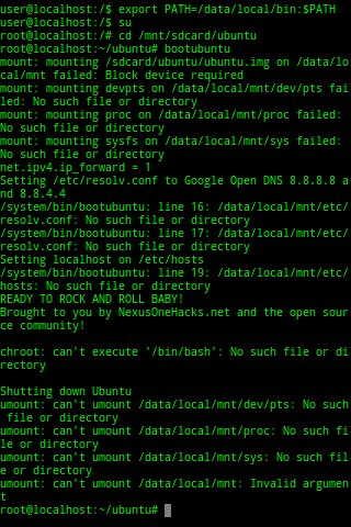

Yes. I had it successfully running on froyo. But I cant get it to work since the gb update. It installs fine, but when I go to run the startup script I get: chroot cannot execute bin/bash. Im working in finding the issue out now.

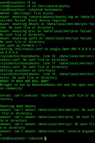

This is the error I get when trying it with the Linux Installer and The Ubuntu for Android method. It sucks cause it worked on Froyo. I'm going to keep working on it though.

I already have the Ubuntu arm and BT5 Arm from the Market and since the GB update none of them have successfully booted on my phone. I keep getting the chroot error listed above. Exgenmeikoj, did you get it to work on Gingerbread? If so how? And you said the have ICS for x86?

I kind of got the Adroid Linux Method to work. I had to download busybox and install it to /system/bin of my phone. Everything went through ok, but when I went to boot it via, "bootubuntu" command it tells me something about mounting errors at data/local. I even flashed my phone back to Froyo, followed the setup instructions again, and it worked fine. I had ubuntu running and working. Went bunch of mounting errors.

When I type bootubuntu, I get:
chroot: can't execute 'bin/bash': No such file or directory
Shutting down Ubuntu
umount: can't umount /data/local/mnt/dev/pts:
umount: can't umount /data/local/mnt/proc:
umount: can't umount /data/local/mnt/sys:
umount: can't umount /data/local/mnt: Invalid argument
