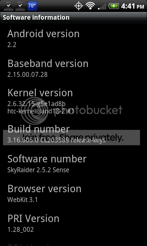

ChiTwon, what kind of voodoo are you doing to get "unrevoked" showing up? Seems the numbers are nice to have, since less obvious if sending in form repairs ;)
Hmm weird it doesn't show anymore now it's showing
3.17.605.0 cl220374 release-keys
I do remember it saying Unrevoked forawhile not sure why . I've flashed about 5 roms and a few diffrent Kernals and updated my radio since that snap was taken last week.

Anyone else not show "unrevoked" for build number?
This is what mine says
