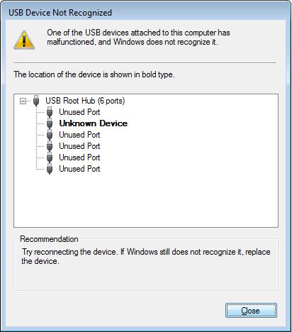

Well I uninstalled Kies and then went to the Samsung site and reinstalled Kies. Tried to hook my phone up through Kies by setting up the USB connection on my phone to "use Kies" no success. So now the question, where to from here. Is there something wrong with my phone? With my internal storage?, my cord?, my USB connection in the phone? My phone is registering on the computer else it would not give me a message plus I get the sound from my PC when I connect it as well as a message. Have I come up with yet another "brand new problem" wtih the Galaxy. I sure as hell hope not.
I took my Galaxy to the vendor and asked them to plug my phone into one of their computers to see if they could get it to work. they plugged it in and up came the menu to ask how I wanted to open up the external drive. We set it for Mass Storage and mounted the drive and it worked perfectly. :eek: I then went to another computer and plugged it in and it actually loaded drivers from the phone to the PC and then I was able to access the phone (and it showed correctly under windows explorer) as an external device and see all the files etc. Now I was getting really pissed. this damn phone was making me look like a fool. they kind of looked at me like I was crazy as if saying how could it not work for you at home. the only thing I can think of was their two computers were running XP the three machines I tried it at home were running windows 7. I am thinking I will go home uninstall all the drivers on my machine as well as Kies and then just try to plug my phone in and see if it loads drivers from the phone. make sense?
I came home uninstalled drivers, Kies and plugged my phone in using exactly the same process that we used at the vendor, same message (device not recognized) came up. Now I was really pissed. Then I read on one of the other threads that an individual haqd just tried a USB port on the rear of his machine rather than the front. I had previously tried different USB's on my PC but it had made no difference. So I said to myself, myself give it a shot. Plugged into the rear of my PC and instantly the PC loaded drivers from the phone and it came up just like it was supposed to. It was in mass storage mode with the drive mounted. Great, I could not move stuff from my PC over to my phone. Then I got frisky and decided to download Kies and see if that would work. Did the task and then plugged in my phone. Told me to change from Mass Mode to Kies. I did that and immediatly Kies recognized my phone and I was away to the races. For the life of me, I cannot figure out what the hell is going on. My front USB ports work fine with everything else. My only concern is that I don't trust this fix. I hope it is permenant but working with this phone makes me think otherwise. Anyway, Thanks everyone for their assistance I could not have done it without you.

So i plug the phone into the laptop and select "Mass Storage" (which has Kies on it, and works fine)....but I don't want to use Kies of coure. I want to connect like an external HD.
It looks like it's going to install drivers, but then it fails to recognize my phone. I have tried USB ports on both sides of the laptop.
I have also tried selecting the USB Debugging.
I'm running windows Vista. Does this matter?

When I plug in the phone........I'll click "Mass Storage", it says "Installing device driver software". It looks like it's installing and then it says:
Device driver software was no successfully installed
Please consult your device manufacturer for assistance getting this device installed.
USB Mass Storage Device Failed
The phone itself says USB connected though. And it asks me if I want to mount or dismount it.

Never mind. This did work, and I tried it one more time and now I can't get it to connect again. Go figure. I tried setting to back to ask connection then mass storage...nothing works again.
