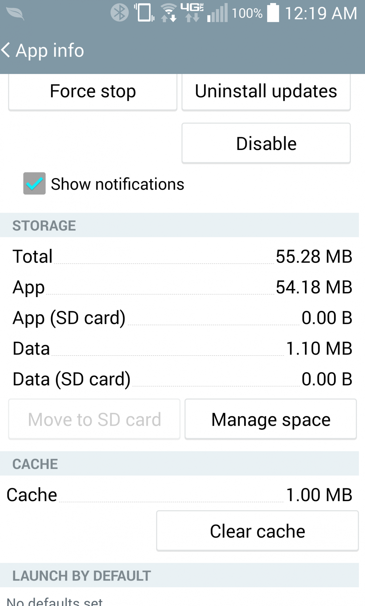

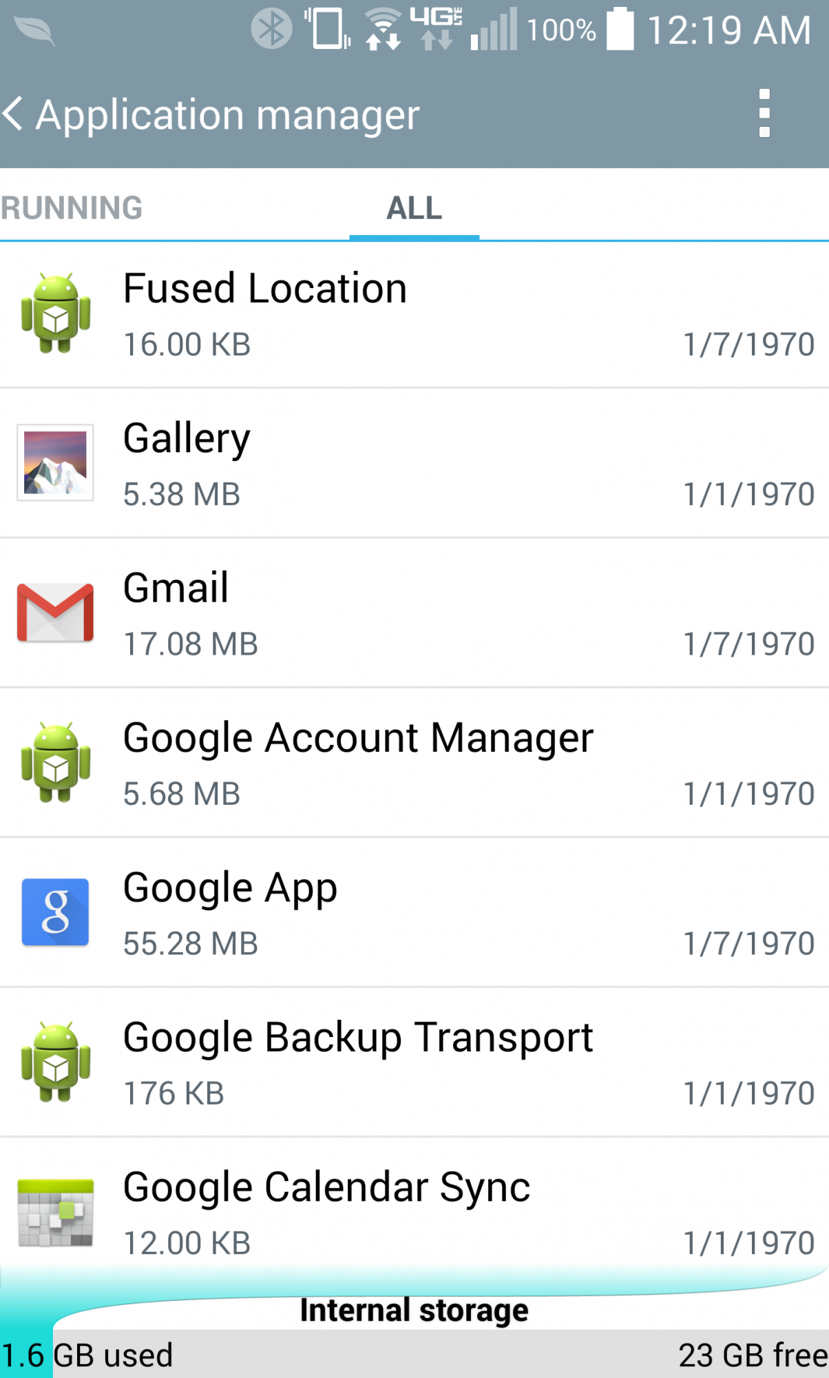

I have two lg g3 the problem with the camera crashing with the video zoom is an update to the google app go to your appsand find google app and clear the cache and then uninstall updates then restart the phone camera should work fine, after the restart google will try to update itself again let it update it has worked on both of my phones.
