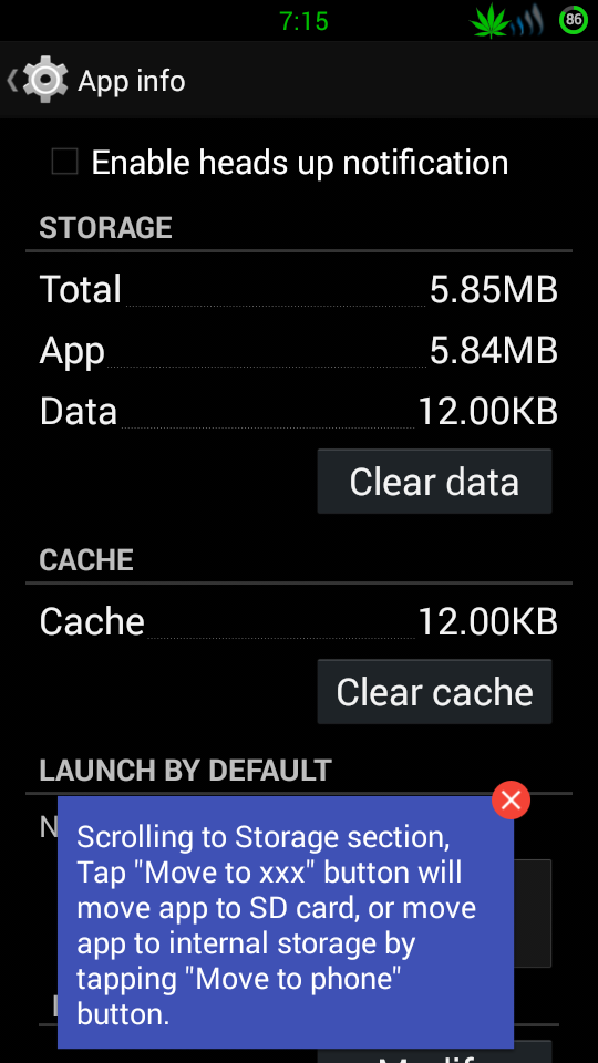

Hi @whoshotjr2006 I've been using this ROM since Fri and its been working great so far. I was wondering if I need to do something to enable apps2sd? I checked out SD fix on the market and apps2sd and normally in apps settings there is the option to move to SD on stock ROM but it doesn't seem to be enabled on SlimKat. It's not a big deal at all because this ROM works so fast I freaking love it lol keep up the great work man!
