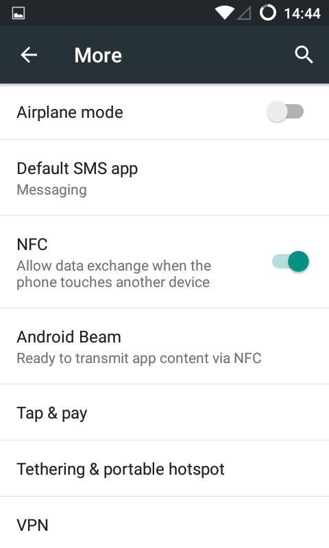

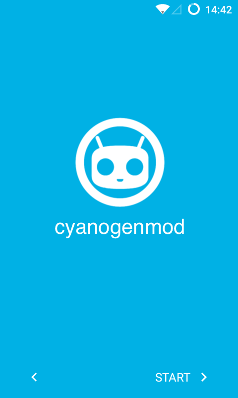

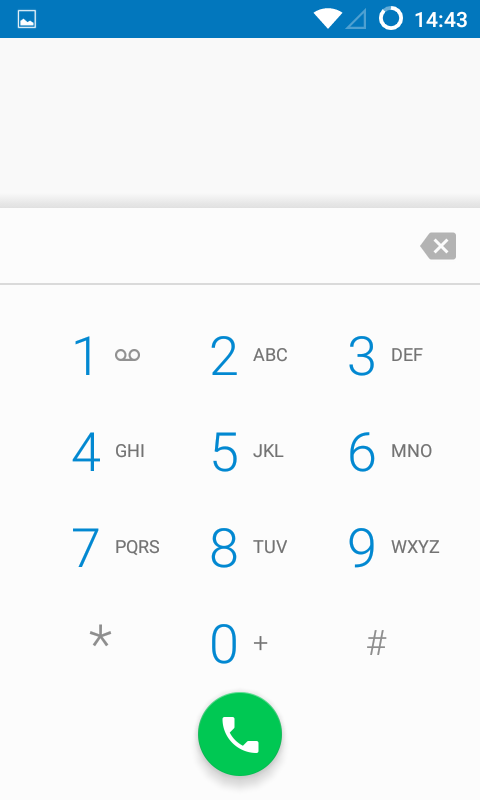

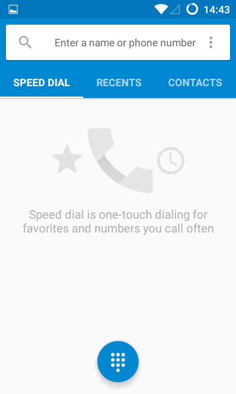

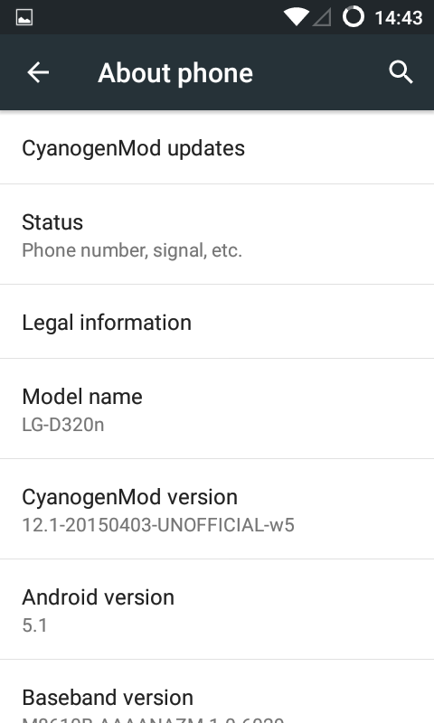

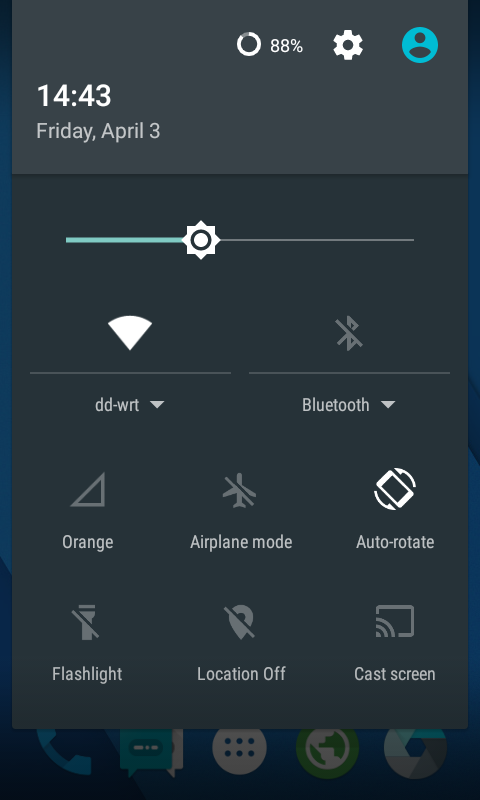

Cyanogenmod 12.1 for LG L70 D320 D320n D325 MS323
My port of CyanogenMod 12.1 for LG l70 D320 D320n D325. It is unofficial and unsupported by the CyanogenMod team.
View attachment 85068 View attachment 85069 View attachment 85070 View attachment 85071
View attachment 85072 View attachment 85073 View attachment 85074 View attachment 85075
Absolutely NO WARRANTY! You can brick and destroy you device!
For advanced users only. Please, no stupid questions.
For install need unlocked bootloader and TWRP (20140403 or later) recovery.
For correct working RIL (Sim detection) and keys you need correct (for you variant of L70) bootloader (aboot.bin).
