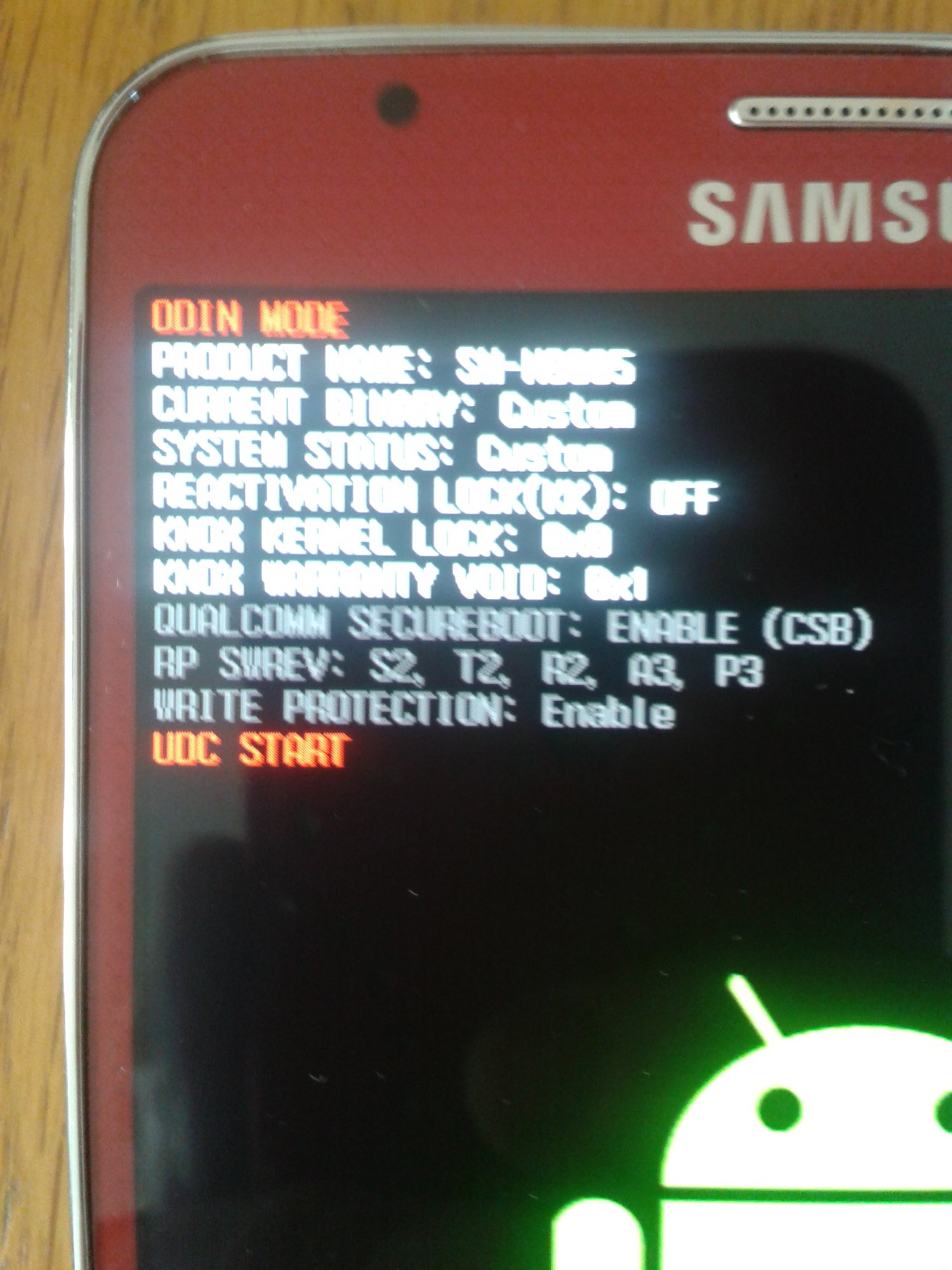

This is what was displayed in Download mode. Don't know if whats displayed has any effect.

I be been thinking (this is dangerous) in Odin it reports "Fail! (size)" right? I think thus maybe to do with the size of the partitions on your phones (usually) inaccessible portion of the memory you actually flash the firmware to. On the Russian leak there was a new PIT file, this flashes the new partition spaces.
My phone is running the Russian "leak" version without any issues whatsoever. If I were you I'd nip over to XDA and download that and try flashing it,mainly because every Note 3 I have flashed for people to Lollipop I have flashed the Russian leak version.
I suspect a partion problem regarding the size fail, I really do. If your Note 3 is currently a "download only brick" I don't think you have much to lose.
