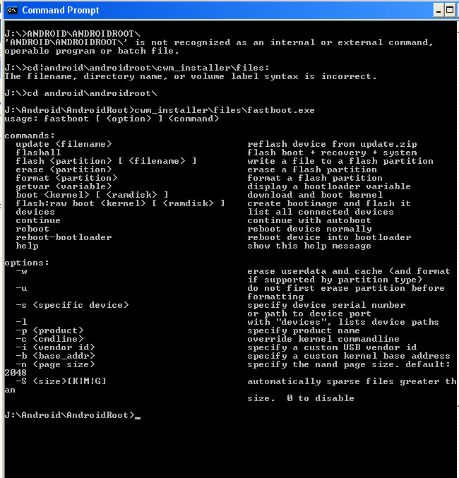

Will you tell me how to fastboot please, I've never used it?
I've been reading from my notes from back in the fall, just don't see what I need, or anything about fast boot. And did try the rooting again, that I did than, http://androidforums.com/warp-seque...-root-zte-warp-sequent-use-your-own-risk.html

You mean through command promp on the PC when it's USB connected/debugging on?? That's, just a gaping hole in my memory banks. I must have, but can't remember the procedure.
you should be good, my tool works just fine on the new rom, you just have to use fastboot mode to install not terminal

sounds like maybe you are on jb stock recovery, although I have not seen it lol. Do you have install zip from sdcard? or just something about update.zip? does it say cwm or clockworkmod anywhere in recovery? If not it's stock and you should try the fastboot method from junkies tool to install cwm.

What, I found after that last post, was this, that SOMEHOW, Junkies tools to root, and recover, (fast boot) scripts, did PARTIALLY, on this JB stock recovery, JUST ENOUGH, to sort of, kick it in the ass! Ever hear of anything like that before?
So, in the reboot (recovery), I went ahead and installed from zip, the root.zip, I'd tried and failed this morning to get the bootloader to install.
So, doing that, DID restore full root to my phone.
