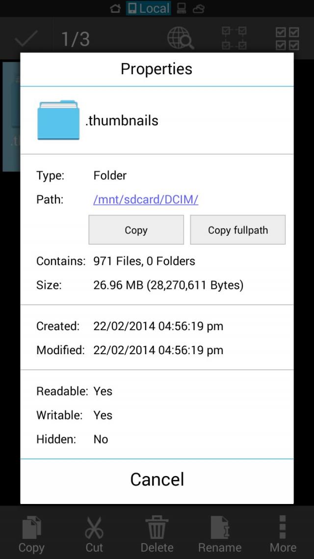

How many pics would you have to take to get 2gb?
Just had a look and mine is 27mb lol View attachment 68009
I dont take many pics mind you but theres nearly 1000 files there.

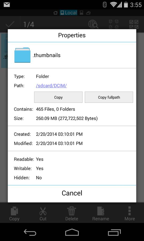

KitKat here too. Interesting that you have 2x as many files but my folder size is 10x larger.

That is strange. Youd think all thumbnails would be the same size?
Im guessing these are all pics i have on g+? Theyre no longer on my phone.
So turning off pic sync would stop them using up storage?

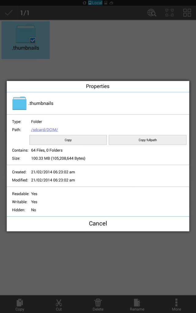

This is my tab on the same account so I'd have expected it to be the same but it has far less files using much more space :confused:
Im guessing thats why then mate(?)
All my pics get synced/uploaded to google+. I dont fully understand how it works though lol
