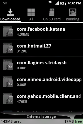

Tanks CMWhatever. You Rock! Unfortunately I don't! LOL followed everything to the T and it doesn't seem right. look at the screenshots below. Partitions look setup right however my internal storage still seems mighty low. As well as the ram, seems low. My apps on "internal memory don't have any icons but the ones on the sd card do??? like I said I'm a noob and this may be the way it is supposed to be IDK?

Need to wipe the dalvik and format the sdext again, everything else looks good. Delete the apps and then reload them after again. How are you restoring your apps?
downloading apps from google..never had much personal stuff on the phone. I copied original sd card to cpu but not worrying about restoring backups. No biggie for now. I re-flashed phone a few times and wanted to ensure I get the setup right.
still the same? onlychange is 2 more apps are now on sd card...wiped davlik and formatted SD ext in CWM (was I supposed to mount sd ext 1st maybe?), should I wipe cache partition also?
