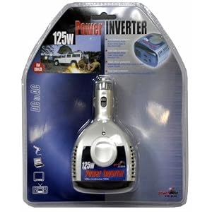

I have had luck with one car charger, but still keep a 125w power inverter ($20 at wally World) in the car so I can plug into AC (wall charger)if the other fails. Hell the inverter even has a usb connector..
LOL...
generic pic not mine...
