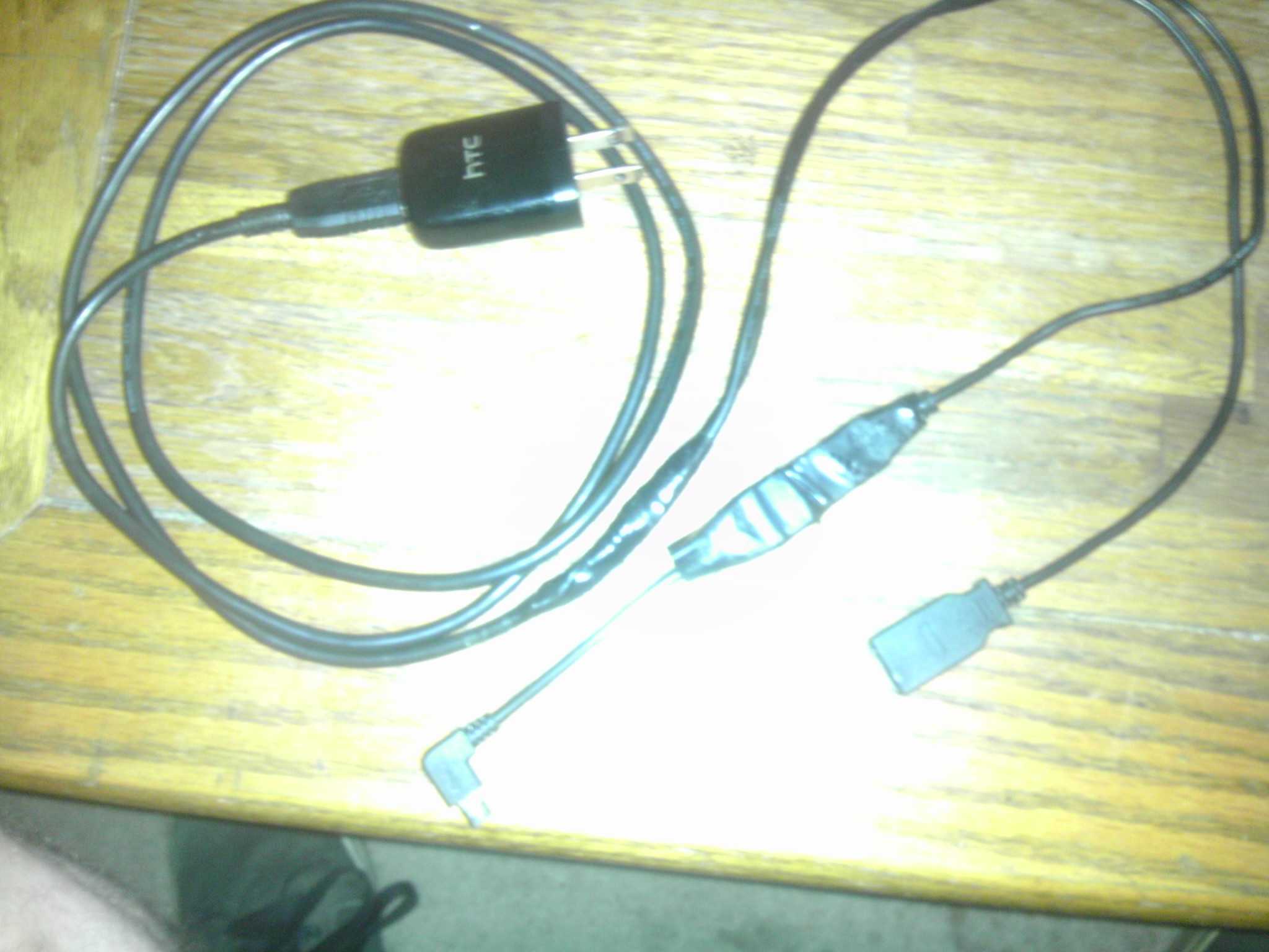

I'm on hw0002 and it is working. Needs to have a powered usb hub or in my case I made a y cable and powered it with the phone charger

What kernel are you using? and rom? Mind snapping a shot of the cable you made? I would like to connect to my tv but sense the micro usb doubles as the hdmi I am not sure how to go about this.

I'm VERY interested in your setup, please post it.

For the power side of the cable do not connect the shielding green and white wires it interferes with usb connection technically you only need the red and black wires for the power supply.

You need to splice in a power cable, as in jdt's pic. The phone won't power the USB device.
