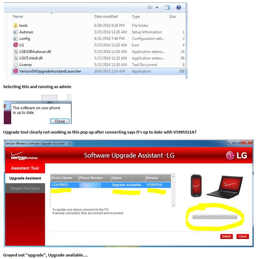

Here's what I've reported thus far-
1) Automatice Brightness Issues (Not working)
2) Screen Sensitivity issues (not responding to paste function in Firefox browser/Samsung Acct for S-Health)
3) Verizon(LG) Software Upgrade Assistant not working (Won't repair or upgrade/button grayed out?)
NOTE: There seems to be some confusion that #3 is the Settings/System update/check for system update via the phone, but in fact IS NOT THE SAME... "System Update" via the phone is Over The Air, aka OTA and is done via Wi-Fi or Data over phone. What I'm referring to is a joint program between carrier and LG, and so far I know of only VZW offering it BUT have been trying to have those with other carriers to do a search on LG website, which I found by carrier below by model # to see if you can update your phone's software via connecting the phone to a PC/MAC and use the software to update?
I AM NOT ASKING YOU TO UPDATE YOUR PHONE SOFTWARE via the program given. What I am asking is whether or not it shows you what software version you have and the ability to update, and whether the button to "UPDATE" is grayed out like what I experienced in VZW/LG software update tool with both of my VZW V20 phones...

1) VZW wireless software upgrade asst not working properly, update button grayed out and undetectable on 1st phone (2) FDR performed, after each OTA, same issue... 2nd phone no change and told to FDR? Really? Uninstalled/installed no change... Clearly software issues...
2) Software Ver: VS99511A experienced 2nd screen issues with 1st V20 having long press issues going into settings and not doing its function? SwiftKey keyboard not recognizing letter "M"
2b) 1st V20 VS99512A second update long press issues AND paste function issues where I couldn't paste or found that could only paste if I long pressed only on the cursor and not like the usual long press anywhere near the paste area? Reason I don't want to OTA 2nd update and want to use the software update tool...
3) Auto brightness not working? Adjust baseline on 1st V20, low lighting and went to "0". Low lighting dim screen? Why even adjust the baseline if suppose to auto adjust? 2nd V20 adjusted brighter and went brighter after?

Sreum getting off point a bit. I'm trying to find out if anyone else is having issues with the 3 things mentioned in the original post?
1) Automatic Brightness issues? (How does your phone adjust when transitioning from dim to bright conditions?)
2) Screen Sensitivity (are keystrokes not recording,lagging?)
3) If your model V20 (Settings/about phone) has a software upgrade assistant on LG website? (is your software up to date and if not can the software, if available update or is the button grayed out?)

Thank you for the reply.
Let me elaborate more on item #3, as it is separate to the software update that is done over the air (aka OTA).
LG's website, link in original post above, and discussed in detail about searching by your carrier model# (My VZW model# is VS995).
T-Mobile model # listed in your phone under "about phone" and something like hardware info, or may vary by carrier. Once you have your carrier specific model#you can input it after going to LG website link listed. There may or may not be a carrier specific software upgrade tool that LG made available, BUT if there is it would allow you to upgrade your software to your phone, and tell you what you have currently. The point is that even with Wi-Fi and a strong signal you could potentially have glitches introduced into your phone... This happened with my first phone. This software was brought to my attention by Verizon tier 2 tech support. Perhaps T-Mobile's tier 2 tech support could tell you but you could easily find out with the steps I just gave you...

As for why online update?
This is not an online update. As stated above its software offered by LG for certain carriers to
1) update phone software
2) Reinstall the OS when corrupted, apparently different than a factory data reset (FDR).
According to Verizon (VZW) updates have a way of corrupting the phoneand regardless of a good Wi-Fi or data connection Could have issues with the updating of the software. I'm simply reiterating what was told. If LG is going to put this software out there and didn't work with either function it was designed for with the (2)phones that I have then why offer it and have carriers promote using it when it's useless? I was trying to take it a step further by trying to find out if all phones trying to use this software experienced the same as me? I clearly posted directions and what it was I was trying to accomplish.
Now as to only one phone version or setup, well each carrier has the right to want to dictate what they want to do, but I believe Napalm posted about "smart setting" and found on XDA Developer forum that there is indeed a work around for this. Two different apps posted here-

4) mfg software that's suppose to assist in repairing updating phone software and Durant (doesn't) *typo left for clarification point...

1) about phone is the OTA software update within the phone and not via the separate LG software, with links provided that you download to your computer and connect to phone in the main post...
The software you download and connect to phone will tell you what software version you're running and allow you to update if there is a new version available and is not OTA.
Case in point, I did a 3rd FDR to 1st V20 and it would not update to VS99513A via OTA via Wi-Fi which is the current OTA software update available andthe 2nd V20 took it fine.
I'm willing to bet if I go to connect the 1st V20 to the computer to try and update the phone software it will still hv the greyed out button...
I'm willing to take it a step further and FDR the first V20 again and see if I can connect to PC and see if the software recognizes then or before I do this put it in safe mode and see if it works? But if memory serves me correct I think I already tried the phonein safe mode and the software connected update doesn't work...
TY also confirming beinga VZW brethren...

software updates - under about phone in settings - is not greyed out. Seems to work, but my last update was in NOvember.

So I tired VZ's update tool and it is greyed out for me - but I'm also on the latest update which might make sense. Incidentally I have 13A now. that update passed though some 10 days ago.
