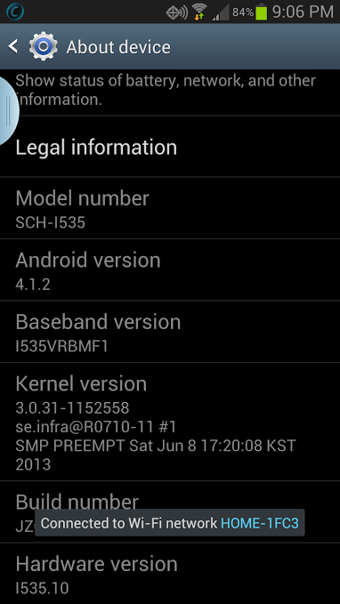

After rebooting, go into menu/settings/about phone and post a screenshot of the info posted there. (not the screen with your phone number or IMEI number, the other screen with "Android Version" etc).

I took it to a Verizon store since i was having issues trying to install a OTA update. Thats how I found out. Plus I contacted the company where I purchased the phone and they confirmed. I told them what I was trying to do. They just said for me to reset to factory settings that should fix my issue. ( ive done that twice) After that didn't work then they told me I would have to find a guide to unroot the device.

The android version you are on, 4.1.2 is the best version to be on when rooted.
That means your bootloader is not locked down and you are free to install a custom recovery, which will allow you to flash roms.:D
As fdbryant said, Verizon may be slow in updates but the rom developers usually take the updates and incorporate them into their roms.
It's also an older device so developers are slowly leaving the S3. So there is only so far you can go with keeping up with the Android versions.
Do you wish to proceed with gaining full root (installing a custom recovery, finding and flashing a rom etc), or do you wish to unroot?
