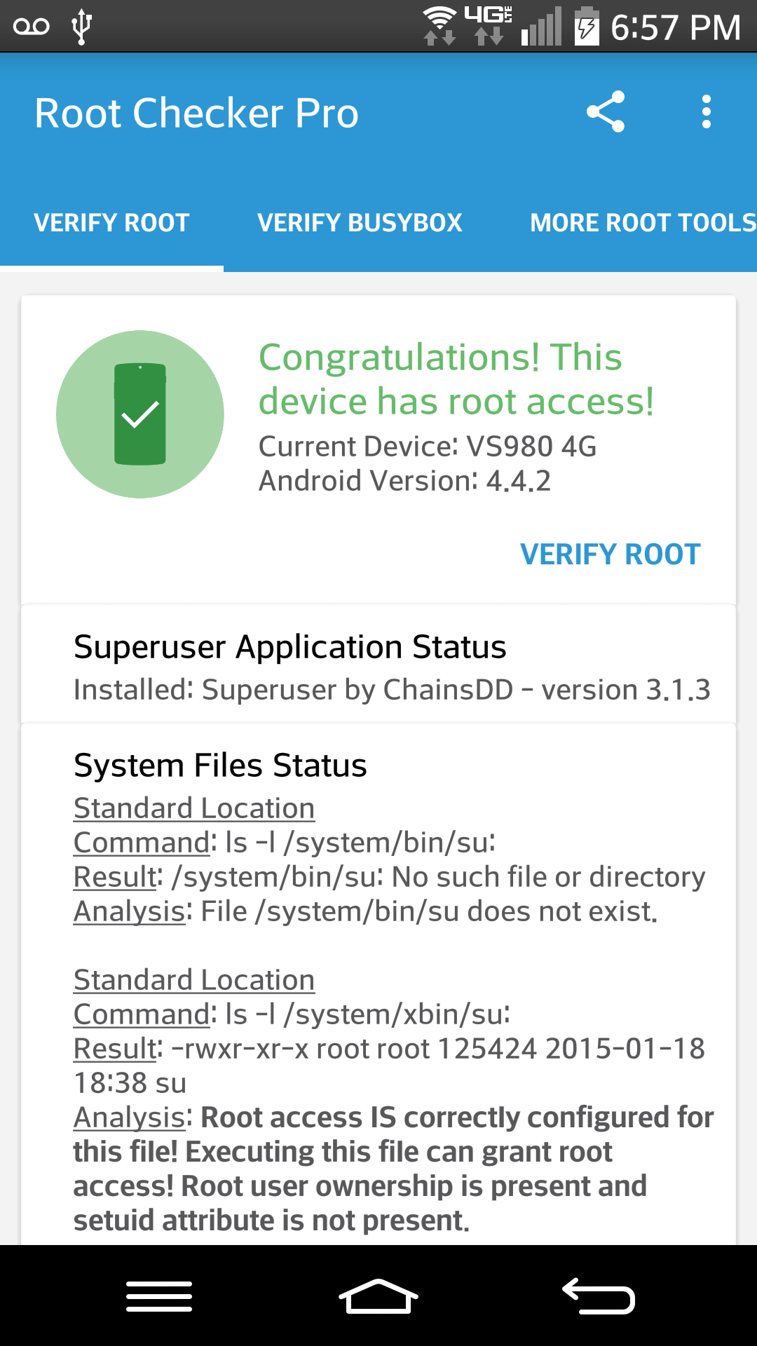

Yes I did the same thing and worked great, but lost root. Oh well.
Great news! Was able to root VS98027A using Stump Root!
