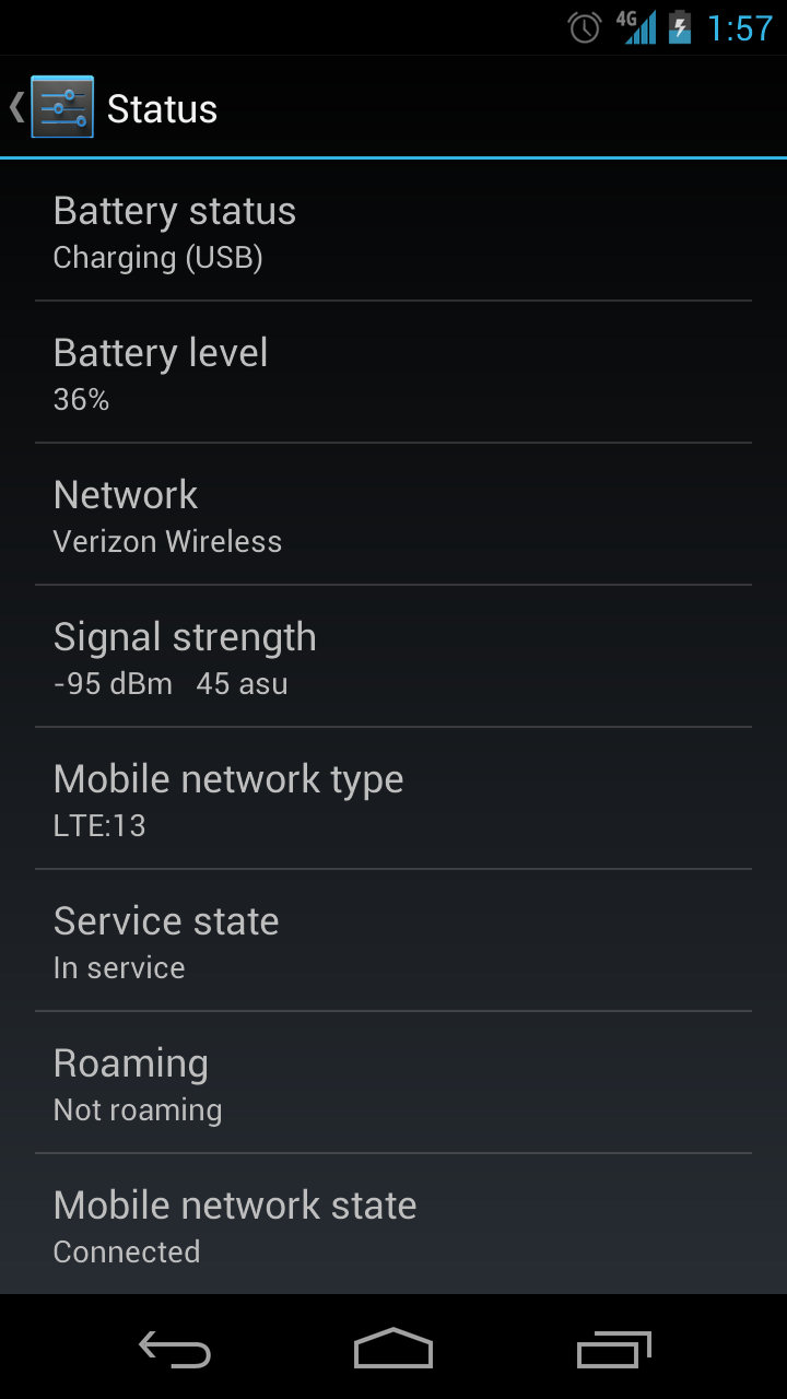

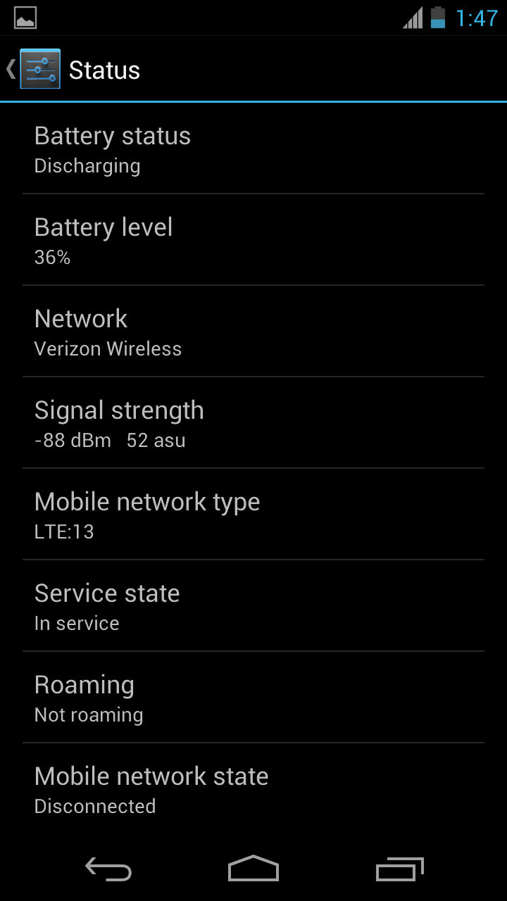

Now anytime I install any ROM my 4g data no longer works. I get 3-4 bars and the little 4g but they are white and I cannot browse out, where minutes before they were 3-4 bars blue. I have even tried reinstalling the new radios separately after the ROM install, still no 4g. I have tried at least 6 different ROMs all with the same result.
I have toggled data on and off, airplane mode on and off, change to just CDMA and then back to LTE/CDMA in settings. In status I have good signal strength, network type is LTE:13, service state is in service, but Mobile network state is disconnected.
I have installed tons of ROMS other phones and never had this kind of issue. Any idea what would be breaking 4g data just by installing a ROM?

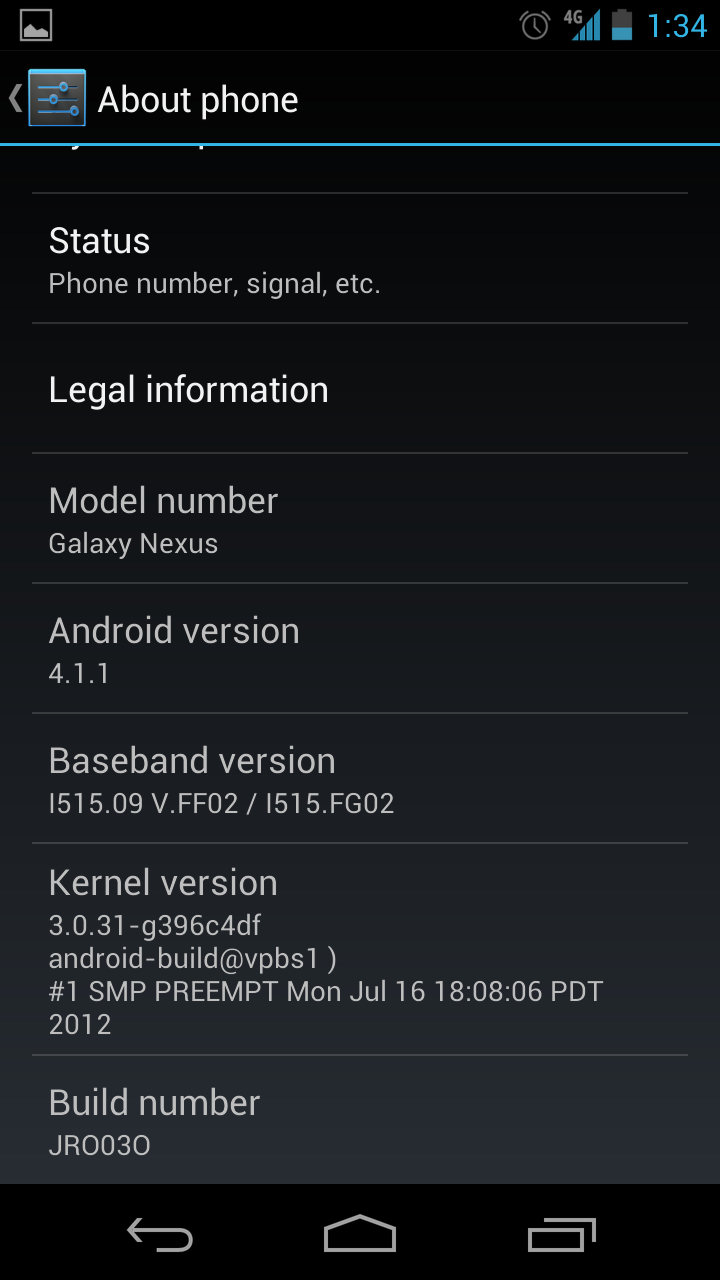

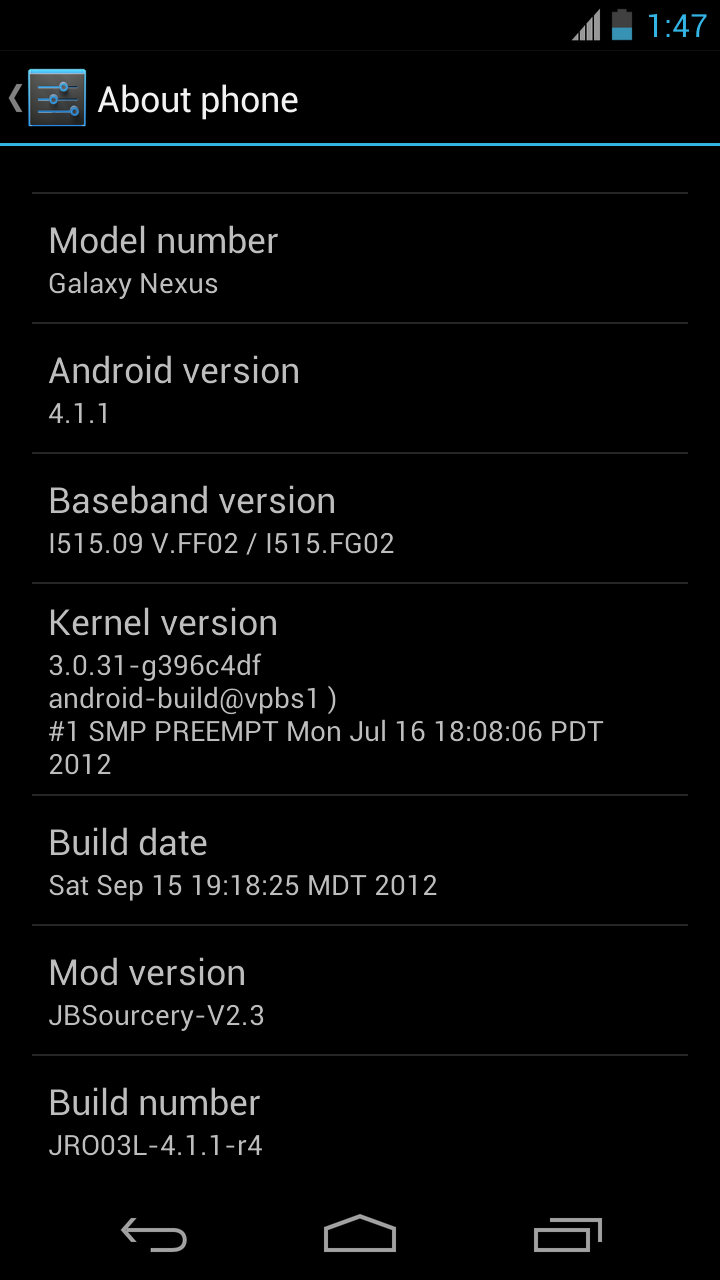

In the pics you can see full 4g blue bars with Stock JB and then just a few minutes later, sitting at the same desk, only 4 white bars with JBSourcery2.3LTE, it's the same for any ROM. I've been having this issue for a while and I cannot find an answer, any help would be appreciated. Thanks in advance.

Aside from toggling airplane mode, disabling & re-enabling data, switching from LTE/CMDA to something else & then back again... What else can I try? Are their some files I can check the contents of for certain settings or maybe check the permissions on some files to make sure they're correct, log files?
I found a post with someone having a similar problem. They had a GSM phone in Canada and they had to edit their APN settings to get it to work. I don't have the APN section in Settings like the GSM phone has. Can this be an APN issue? I have searched and haven't found how to edit Nexus LTE APN settings.
