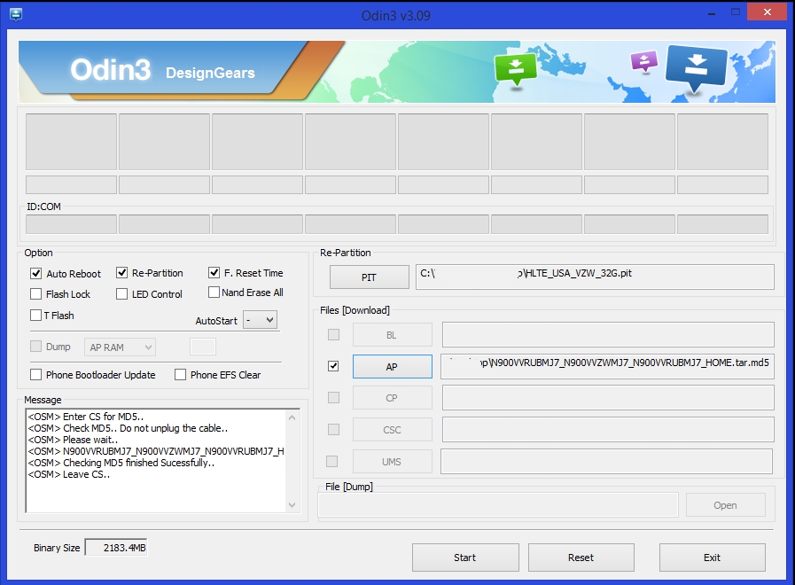

Wouldn't hurt, if that doesnt work, battery pull and put it back into download mode .. redownload the MJ7 odin file you shouldnt have to rename anything the file name should be N900VVRUBMJ7_N900VVZWMJ7_N900VVRUBMJ7_HOME.tar.md5 size 2.13GB.
It should look like you have it in this picture http://i.imgur.com/67HhRvR.png?1
except in the AP box it shouldnt be .tar.tar it should be .tar.md5 ..shouldnt give any error when you load it into AP if it downloaded ok flash both and it should reboot you back to complete stock
** I uploaded a picture of what my odin looks like if I were to put mine back to stock. As you can see comparing to your pic it looks like your binary size is wrong, yours says 1401 whereas it should be 2183.4MB

You shouldn't have to rename anything, see the picture I posted above. Redownload the file, it looks like the one you tried didnt complete, as the binary size only says 1401, it should be 2.13GB (2183.4 in binary size)
Ahhh yes okay, it does say my binary is invalid, when I load my file..Which is odd, because it's the EXACT file that you gave me..
anyway, do you know how I can change the binary? it looks like this is all i need to do..
