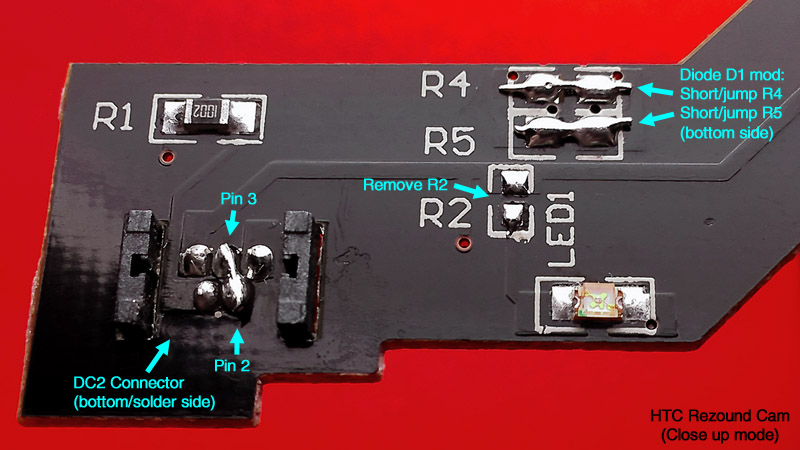

Hey guys, here's the latest mod and hopefully this is the last mod :) This is with the DC2 pins 2 & 3 jump, diode D1 jump/bypass (use the R4 and R5 at the bottom side) and removing R2 for safety. I left the D1 diode in there (we don't have to remove this D1 diode/component). The blue LED of course doesn't work after we remove resistor R2 but we already have an amber LED on the phone itself (at the "top-right" of the phone next to the Verizon logo) to see that it's nicely charging.
Here's a picture of the combined modifications:

Amazing work, andr01d! Thank you for posting! I'm pretty good with working on small parts, mechanical watches and stuff, but I've never done any soldering before. Got any tips on what to get at Radio Shack for this mod?
This info is printed on the packaging/box or on the adapter itself. If it's not on the adapter or on the box itself, then it's most likely the standard 500mA (0.5A) type. They just have to print 1A or 2.1A on the box/adapter because it costs a little more than the 0.5A type, and they want us to know it has a higher output. Sometimes they may also print "fast charger" on the box along with a 2.1A or 1A info. bye.
This will be very helpful because the pins/pads on the board are tiny (they just look big in the pictures). However I should mention the degree of difficulty is also high because it's in the SMT (surface mount) territory, but it's not as difficult as the ultrafine-pitched SMT/BGA stuff where we literally have to be a robot to do it. [...]
So if you don't mind I think it may be faster and safer if you can ask a nearby friend or an electronics repair shop, show them the picture, and ask if they can do it.
I hate to ask, but is there any chance you could give me an actual dimension of the pins and spacing? I have a couple of friends who have lots of soldering experience and tools. But, I want to avoid taking the cradle apart, drive over, and then have them shake their head. Of course, one of them is more experienced, but the younger one owes me a favor...;)
I googled and found this page Surface mount part types & jargon that refers to typical pin spacing ranging from .5mm to 1.27 mm. Can you hazard a guess what the spacing is?
ha ha. umm... it's 1.3 mm pin-to-pin (micro-B format), and 1.5 mm from row-to-row. :) have fun...
edit: the two rectangular things next to the pins... from outside-to-outside it is 8 mm or 0.315 inch wide, and top-to-bottom is 5 mm or 0.2 inch.

Thanks for the mod instructions! I have just performed it and it appears successful. Man those little pins are tricky, and I consider myself experienced!
With GPS/Navi running stock and a 2.1A car charger from best buy, the phone would still LOSE charge. I'm hoping next week I'll see a difference.
