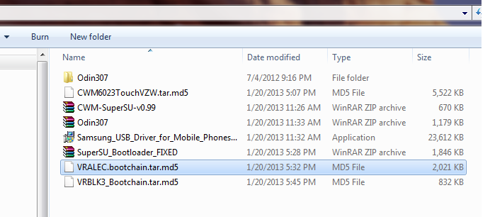

I do have all those things pictured. I have a few extra things that you don't have but I am thinking that won't be a problem right?
That's fine, and the SuperSu_bootloader.FIXED should be on your sd card.
I know you see it in my folder up there, but thats fine...its also on my sd card.
Any extra files in there is fine.
What other files do you have in there?
These are all the things I've got in there at the moment.
Looks fine to me.:)
