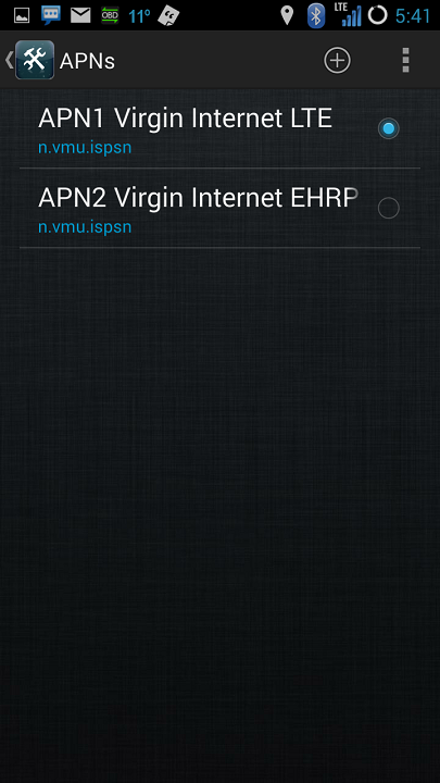

Fix 2 says it receives only, and doesn't send. Can you do both on LTE?

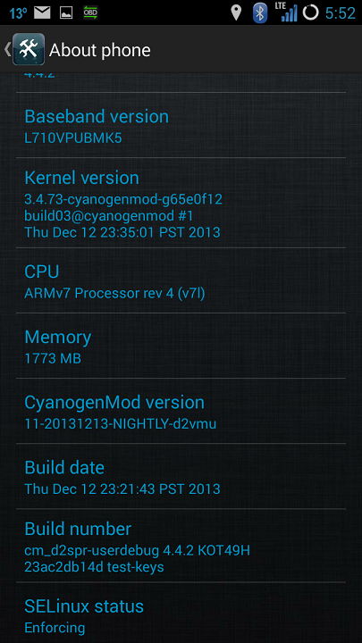

Are you positive your phone didn't revert to 3g at any point? Do you happen to know what modem you're using? Mind taking a screenshot of your APN page?

I don't believe that it shifted to 3g,
I'm still quite new to this.
I know that 'this' is a biggie I'll do what I can to help and provide information so others more skilled and experienced can proof this .
It still appears to be working both send and receive this morning

I can confirm that on the mk5 modem using riders 2nd fix, I have successfully sent an MMS using 4g. I am on the dec15 from the op
I got mk5,did fresh install for cm 11 on the 15 the nightly release, and did MopedRyders 2nd fix. No luck for me. I can send, not receive.

I was able to send but not receive mms over lte with the mk5 modem. Have you tested receiving?
To you guys trying to get the second fix to work over LTE, I would suggest trying what I finally got to work. MG2 modem with second fix allowed me to send and receive, would like to hear feedback and see if it works for others as well. It's the only thing that made sense to me is if some users were on other modems and flashing the second fix just worked out of the box for them, I believe if we looked into it we'd find they were all on MG2.
