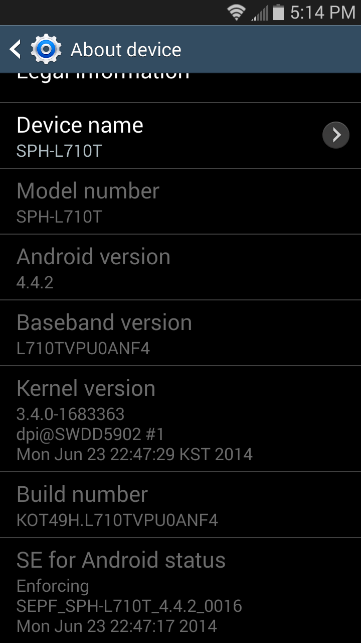

Ok got a replacement and the root method in op isnt working for me.This replacement has different baseband than my wifes andcshe just had and update.Any help in the rite direction would be great.model # also has a T in it.See pic
Edit:found out whats going on.
