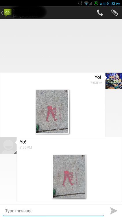

MMS & 4G LTE Confirmed Working on latest fix!!!!!
Hardware/Firmware: SPH-L710 (Originally MD7 Base) Had been upgraded to MG2 Bootloader & Baseband.
Recovery: d2spr version CWM 6.0.3.1 Download Here
ROM Flashed: [ROM] [4.3] Slim Bean (d2spr) --- Slim-d2spr-4.3.build.1.4-WEEKLY-1135
FIX Flashed (After Initial Reboot): CM-AOSP_D2VMU_APN_FIX-LTE
I attached a screenshot with proof of me sending a MMS to myself...
Also I used LTE in Georgetown University in DC as a tether and a square credit card reader all day long with extremely consistent and reliable signal and ping time.
