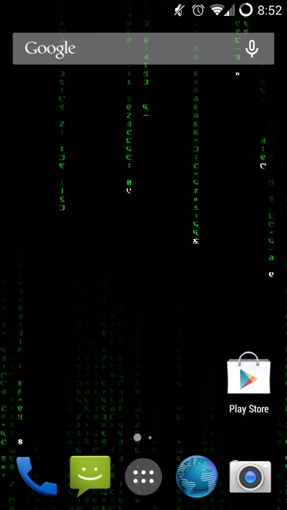

Thought I'd post a screenshot of my wallpaper with this CM11 nightly 17 ROM. Hope you all like it!
