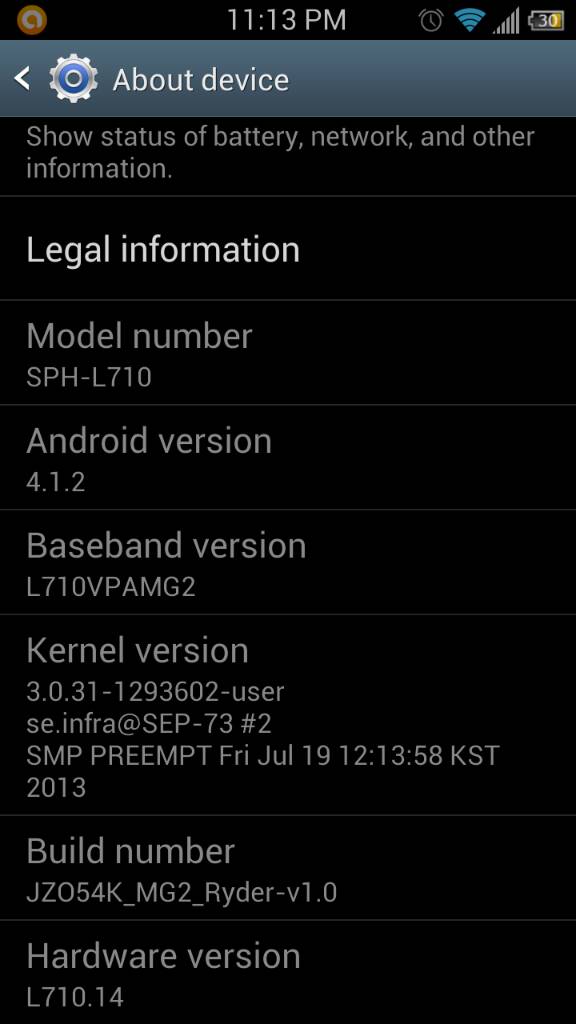

Flashed base Rom with center clock mod everything is running solid with 0 problems. Even my Google voice is working correctly now with no echoes.
Thanks for the Rom
