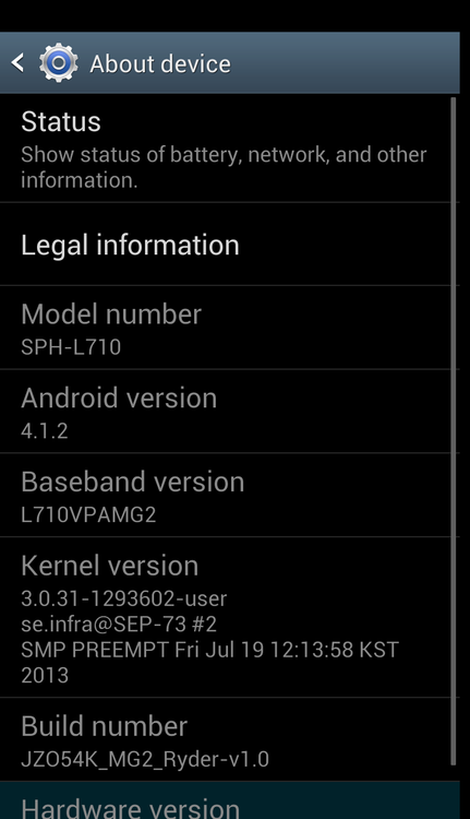

WHAT I DID:
MG2_Ryder is a ROM build from pulling most files from my phone and editing / adding some stuff. Its fully deodex'd and ziplined. I debloated the ROM as best as I could (pulled unwanted apps) - its an ongoing battle. I also provided a link to "rebloat" the ROM if someone wants all the extras. I originally worked on trying to port the Hyperdrive ROM, but decided it would be smoother just to take a stock MG2 and added want I wanted. A lot of my inspiration came from that ROM so big props to the HyperDrive team.
--I then pulled some .png files from themes and created 2 full themes for you. Xperia theme mod with addons and the Sense 5 mod. I also prefer the clock to be centered on my phone - so Ill have that option for you as well
I will also try to create a flashable "Return to stock" package. It will also reset system files and most primary ROM files all in one. Ill also repackage some Sprint Kernels and (test first) for you to try - with return to stock kernel of course.
  • Pulled files from my Factory MG2 Phone
  • Fully deodex
  • Removed a TON of system apps
  • Updated / added some system apps
  • Changed a lot of .png files
  • Zip aligned every system apk
  • Added a Reboot menu
  • Enabled init.d support
  • Enabled boot animation
  • Added some init.d tweaks
  • Added camera shutter sound support (check local laws)
  • Added 1% battery
***BUGS***
  • None yet - please report

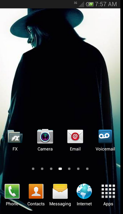

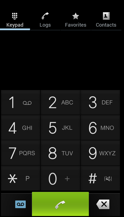

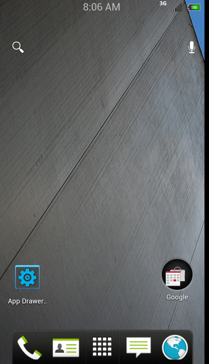

SENSE 5 THEME / MOD
Here is the ported Sense 5 mod from the Hyperdrive ROM
If you like to have the clock moved to the center of the phone (like me) then here is a Center Clock Mod. Dont flash it after the theme above without rebooting first to make sure. Along with moving the clock to the center of the status bar - it makes it 100% transparent. See pic #1

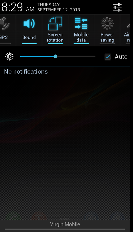

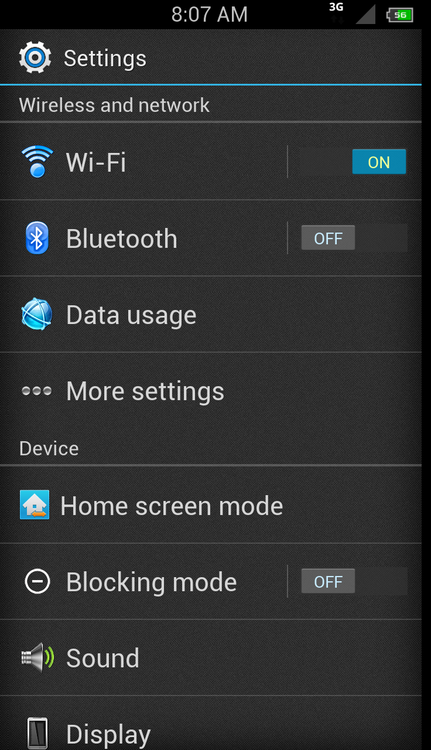

XPERIA THEME / MOD
Here is the ported Xperia mod from the Hyperdrive ROM

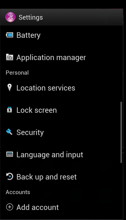

i cannot access language and input :(
it hangs and crashes. ill try reboot again but idk how to produce the logcat thingy
