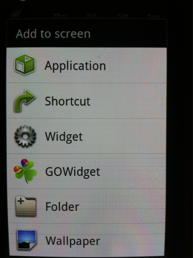

I posted something similar in the past but didnt get a proper answer, it turns out that a few weeks ago i started noticing some weird grey horizontal lines at the bottom of the screen, you can sometimes barely see them, other times very easily, it seems that when you have a white background they are very easy to see, but i just cant seem to remove them, they are static, they dont look like dead pixels (already triend a dead pixel fix app from market for a couple of hours with no luck), they look more like the screen were folded in some way and then straighten back.
I got some photos i took with my iphone, since you cant see the lines if you take a screenshot, please check the bottom part because thats where most of the lines are concentrated, they are grey and very thin,i really hope someone can hlep me because if its a warranty thing i will have a bad process with this since i bought the phone when i was living in europe and im back to mexico now. So i dont know if Samsung provides worldwide warranty with phones which i really doubt it

I have also noticed this on my S2, I have had 3 S2's due to other issues and only the 3rd one (my current one) is like this!
I find when I first turn the phone on there are these lines and the left side of the screen is very very yellowish... Only the left side thought!
I have found that those above problems are only there when first booted and all I have to do to remove them is turn the screen off, then on again... SO basicly lock the phone and unlock again and the problem is gone! It's absolutely mad, I don't know why it does it, I have also tried many different ROMs and they are all the same in terms of this issue.
It's not a huge problem cos all I have to do is turn off the screen then on again but I am not happy because it shouldn't even be like that, its an expensive phone and all I have had with my S2's is problems although I have to admit it's a great phone!!
But anyway I digress, i do have this problem and it does suck (when its visible anyway). :)

Hi Friends,
Just to update all of you and any one and everyone who faces this Horizontal/vertical grey lines on their Samsung Galaxy SII GT I9100G. It is indeed a Hardware issue and not a software issue. I had tried installing all the official Samsung stock ROM's from Ginger bread to Ice cream sandwich and even the custom ROM's of Cyanogen, AOPK etc but still the thin horizontal gray lines were there on the screen. I could even make them out on the Lock screen and even during the boot screen when Samsung logo comes up. So if you are still facing this problem than the Only solution is to get the Super AMOLED+ display screen replaced. Mine was replaced free of cost by the Samsung Authorised service center (Al-Nadi) in Jeddah Saudi Arabia. The warranty in Saudi Arabia is provided by the Al-Nadi for free replacement of parts & labor for 1 year after purchased and an additional 10 Years warranty only on labor charges there after. The Al-Nadi service center replaced the Super AMOLED+ screen and the entire front bezel and also updated my phone to latest official Samsung Ice cream sandwich 4.0.3 and returned me the phone next day. They could have done it in few hours the same day as well but they were not having the AMOLED display in stock so had to get it from Samsung. I had to put a new scratch guard for the phone as the earlier one got replaced with this new display screen. Over all now the phone looks brand new and performs really fast with ICS 4.03 and the new display is just crips, sharp, bright and Vivid.
Thanks a lot to Samsung and Al-Nadi (Authorised sevice center for Samsung in Saudi) for replacing my display and solving this annoying gray line problem for such a good phone. I just love my Samsung Galaxy S II GT I9100G model and going to keep it for a very long time. Hopefully with this service experience my next phone could be again from Samsung stable.
Will shortly update this post with Al-Nadi Website link and their contact numbers just in case anybody living in Saudi needs it for claiming their warranty.
Regards.
