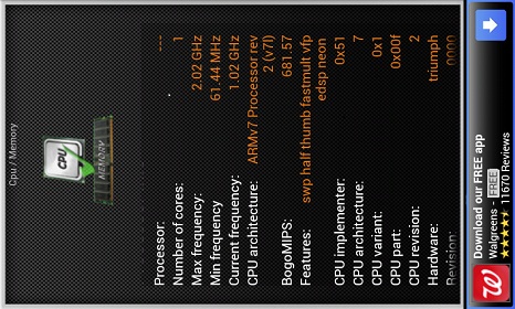

Actually it's a S2 scorpion. It only runs at 800mhz so that probably isn't accurate at all.. You can try to use z-device test and got to the cpu section and see if it shows your cpu model number.
Whoops, I made a mistake. They are both S2, you're right. That was me inadvertently saying it is a S1, not what DPS said.
Screenshot: screen66.jpg
1 core and no processor name yet frequencies look right. The revision and serial # are filled 0's. What do you get?

Screenshot: View attachment 29195
Idk. My MT's touchscreen doesn't work so I can't test. But that looks all like it would be the right processor.
