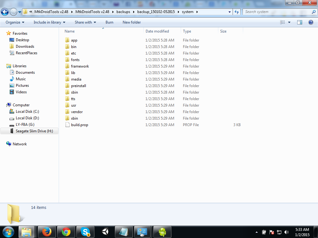

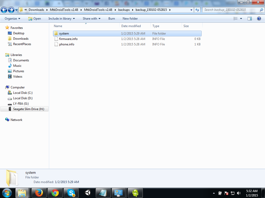

i have extract rom but still can't find any boot.img or .img check below image what i got when i create backup of rom
Do u have your pc showing hidden files if you give me the rom or link to it i can see if i can get it from my end
It looks like you have just dumped the system partition. The boot.img lives on the boot partition.
I think you will need to dump the memory block that contains the boot partition. I'm no pro at this stuff, I can only try to help a little.

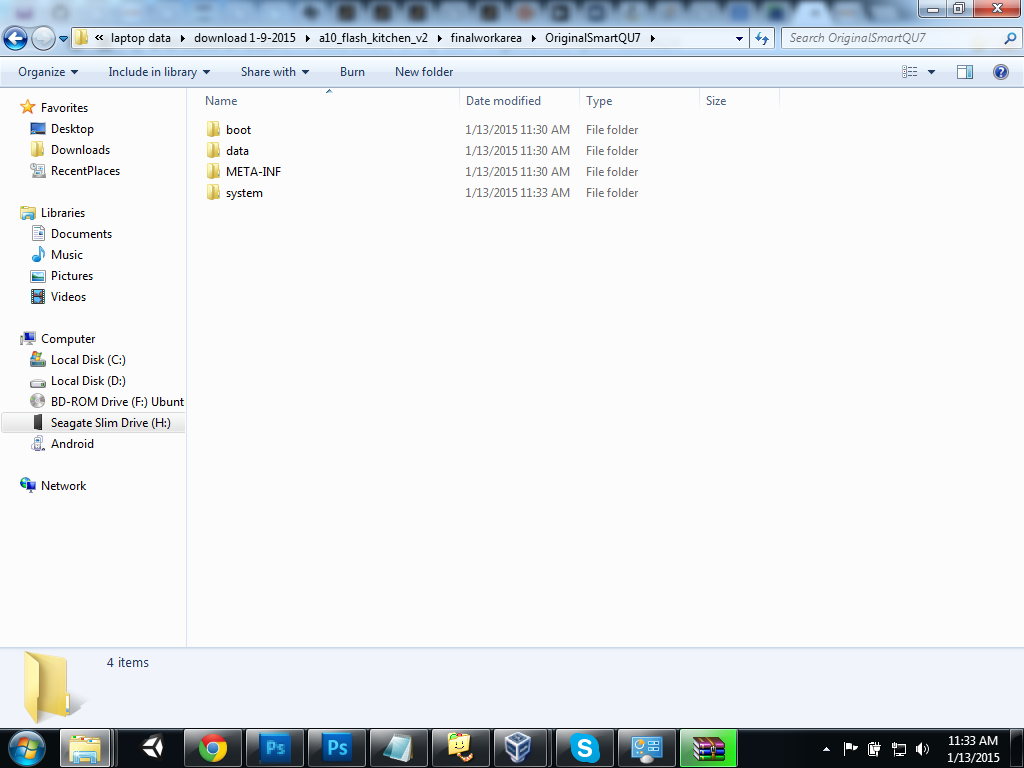

hi, i am using smartq u7 and i have download there rom, and now i can see this all files
i have add u on skype . cyberdev
and i am dam sure splash image is in boot folder

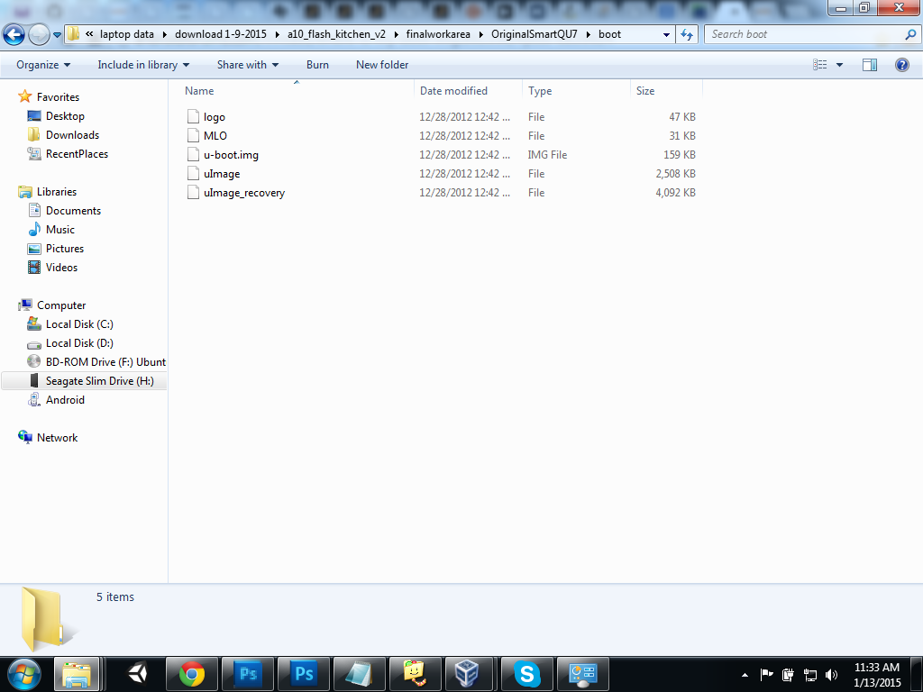

this is boot folder
first file logo is bmp file, and i change it according many times... and save it with same size and size format
u-boot.img i could not extract it, i google to much, i have install virtual machine also still can't figure it out.

no, i have use many methods using linux, using window, i am attaching here u-boot, you check this.
check boot.zip, in this i have attach all files contain in boot
actually guys, i want to change slash screen, i mean boot logo, i have search many ways to do it but i could not find it, i think logo is coming from this boot.zip can u guys please let me know what i do to change logo.. please. i have change logo file it is bitmap file but can't change logo please help me out
no actually i have download rom from original website my tablet is working fine, issue is i want to change boot logo, and i think boot logo is in u-boot.img i want to extract u-boot.img
That's as far as the extraction goes.
Within the boot.img there is a uboot.img. That is what I have linked above because it seemed you were having issues extracting it from the boot.img. Is that not what you're wanting? If not, we are having communication issues I'm afraid.
Edit: ok I think I see what you are asking for now. You are wanting to further break down the uboot.img? I don't think you're heading down the right path there personally. I haven't looked at that file in particular but I assume its a binary file so unless you think you can hexedit that and get different results, I'm not sure what else to do.
