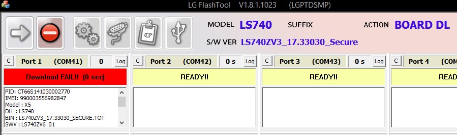

ok here is the background:

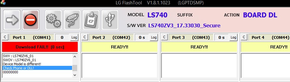

My rooted Boostmobile Volt had Carbon remix rom with TWRP 3.0.0.0 and one day last week it just started rebooting itself endlessly. So I tried holding down Vol+ and Power to gt into recovery TWRP and now TWRP just reboots endlessly too. So I figured something is totally messed up lets just try the brick recovery here get back to ZV3 and go from there http://androidforums.com/threads/guide-brick-recovery.893332/ . Downloaded all correct files checked MD5's and followed procedure to a tee. Got it into Download mode holding Vol- while inserting USB just fine and see the D/L screen like I should. After running LG Flash tool correctly all I ever get is DOWNLOAD FAIL with " Device Model is Different " " Check Phone or DLL " See both pics I incluided. Even tried different USB cables. Always the same. Anyone ever encounter this problem and find a solution? Maybe I'm overlooking something. It just seems like it doesn't recognize my Volt at all.
Or is it possible this thing is hardware bricked somehow? Is there any other way like ADB thing to get it back to ZV3 ?
thanks

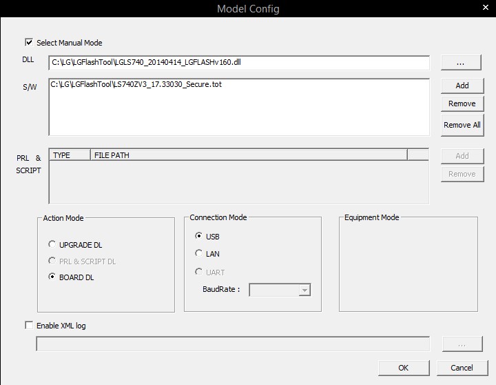

Can you post a screenshot of the setup window so we can confirm that you are setting it up correctly?
Everything looks right... I've seen that happen before, but I don't remember what the fix was.
well shoot I tried my old laptop with XP and same results, NADA same results as before. Even re-downloaded all files. Then I tried DPTools and it can't even communicate with phone, keeps saying " Waiting for device ... " no matter what buttons I press on that tool. So I'm guessing thats why the LG Flash Tool FAILED, it can't even see the phone. So I'm guessing its permanently bricked unless someone has another idea?
Ok so I know now that I have soft bricked my Volt not hard bricked it because it does power on into this TWRP bootloop. It's TWRP 3.0.0-0 btw. After googling " TWRP bootloop " I noticed other android users encountering same problem, mostly Samsung and LG devices. Most refer to ADB of Fastboot commands to try to reinstall TWRP or reinstall original recovery and go from there. Anyone know procedure for our Volt to do this? I've never used ADB or Fastboot so keep that in mind. Also I saw some reference to using TWRP terminal commands but I have no clue again how thats done since its bootlooped itself. I know this should be recoverable just need one of you experts to help out. Also, if I can unbrick it I plan to go back to TWRP 2.8.7.0 I think I got into this mess after I flashed the newer TWRP 3.0.0-0.
