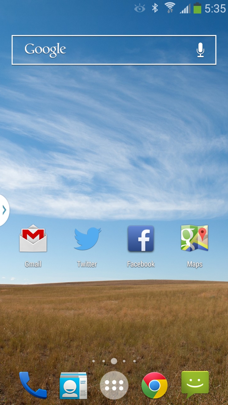

Help why does both.. WIFI and 4G LTE icon both show up?
dan330
Extreme Android User
AT&T Note3...
Normally only one or the other would be on the Notification Bar. (Wifi or 4G LTE icon)
I noticed starting a few days ago...
now.. both are on the notification bar.
I see both the wifi icon and 4G LTE icon.
why? what is going on? does it need to be fixed?

** I found this thread over on XDA
http://forum.xda-developers.com/showthread.php?t=2479362&highlight=4g+and+wifi+icons
They suggest turning the app "Caller Name ID" off. (I froze this a long time ago which may be why I dont have the problem)
"You need to disable (turn off) "Caller Name ID". Go into manage apps, click Caller Name ID and select "Turn Off". That worked for me."

what am I turning off? how does this effect my phone?
update: I have NOT changed a thing.. and the 4GLTE icon is not gone..
It's a bloatware app installed on the Verizon Note 3, not even sure if ATT got it.
Disabling an app does nothing but turn that app off, you just hit Turn on to reenable it if you want to

The Verizon "Caller Name ID" app forces 4G LTE on when on WiFi.
This started happening after an update that activated a trial of "Caller Name ID", which shows you the name of some callers, but also pesters you to subscribe for an additional cost.
Stopped the app and now I'm back to just WiFi showing when connected. I find this comforting because I don't wonder what connection is being used for data when on WiFi.
If you don't see this app in Application Manager, be sure you swipe to see Running applications, not just Downloaded applications.
