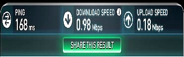

Dear Contributors,
Here's test result (after all measures in previous post implemented)
Picture attached.
I'm getting just under 1 Meg as a download transfer speed.
I'm getting 168ms latency (My data packet round trip to server back to my PC)
These figures are acceptable, but will vary widely on a wireless network.
Test Criteria:
Sunday Sept 23 2012 - 8pm
Android Phone: HTC Wildfire (Android OS 2.2.1)
Throttled Connection?
Difficult to ascertain with certainty. My ISP appears to be doing this, since data rates can slow to a crawl. I was also told two different stories about tethering. Before I bought the phone, I was told I "can plug it in and use it as a modem". After I bought phone I was told "we don't allow tethering".
Kind Regards, oldschooltech
