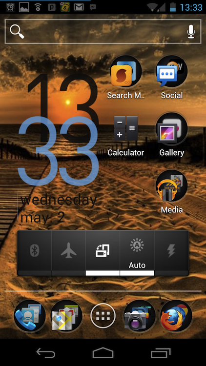

Here is what it looked like at the dunkin donuts, this is driving me quite mad.....
maybe it is airtwist that is causing this problem
Then that's definitely your problem. You are connected to wifi.
Pretty much the only fixes I can think of is making the phone forget whatever access point its connecting to or disabling wifi. Not much you can do.
Your phone is connected to their Wifi point, but the data is not authenticated yet. That's why Wifi bar looks gray. This happens often with public Wifi points. You need to go into their web page in browser and click button to accept it to use data on their Wifi.
