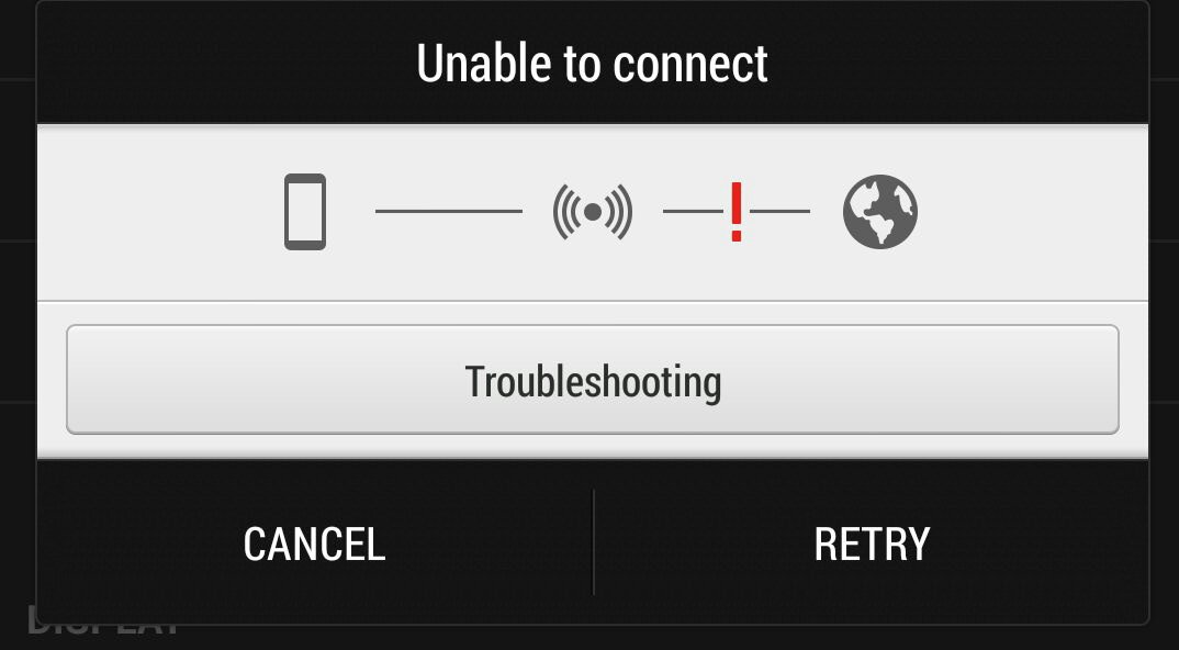

Hi all,
I've managed to get my hands on the Max - besides my fingers getting a little sore from over stretching, loving it ;)
So far, only gripe is this popup message. Appears every time the phone is restarted, and sporadically every hour or so.
I can confirm that internet connection is still present as I'm generally in the middle of browsing or streaming.
Just thought it strange for it to appear when there's actually no issue.
Any ideas would be appreciated :)

that shows you are NOT connected to WIFI or you dont have an active internet connection at that time.
you say you are still connected, it could be that you still have a cellular connection that takes over when the wifi connection fails.
its wise to go to another wifi area and test to make sure its not the phones hardware.
if you can reproduce this error at other wifi locations, the phone should be replaced.
Definitely still connected - my monthly data limit through 3/4G is pretty low, so that connection is always turned off unless I need to access something, so I know my connection is genuine WiFi.
Have had it happen in other WiFi networks also, though it hasn't been as prominent today as yesterday.
No one else has had this issue?
what are your wifi settings? do you have it set to notify you when wifi networks are avail?
do you have power save wifi ticked? I forget the proper name of this but im close.. :)
there are other notification options. when i get to my phone ill check these but let me know what options you have ticked.
when i get a new device, i always disable all the nag notification screens...
