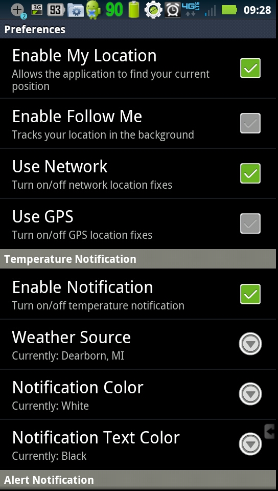

I had the same problem - unable to turn Wifi off permanently. It would restart in about 20 seconds when any wifi signal was detected, then off for a moment, then mostly on. It was caused by the "My Location" setting in WeatherBug Elite, in Preferences. Unchecked "Follow-Me" to stop this problem. Problem Resolved. Have a great day.
