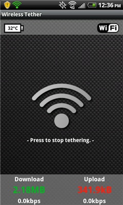

Did you try to connect a device to it? That's also the screen I get when first load the app and press for tether. Once you connect a device the numbers will start to show what your getting for speeds.
I too was confused thinking that it would show numbers when I start the app, it doesn't work that way. I tried a bunch of different versions until I realized I was using it the app wrong.
Thanks. Hooked up my laptop and there you go! ;)

hey so in the interest of keeping this post alive and trying to help this guy(me).. ive tried all of the above and i still cant get this connected... gettin the low .4 .1 u/d speeds. tried to connect my laptop and tether is available with excellent signal but it wont identify/connect. tried repairing thru my network connections on my pc and still nothing. i just rooted with unrevoked3.2 and im running netarchy-toastmod kernel revision 4.1.9.1-cfs and his Burnt Droid 1.1 rom.
update:: nevermind messed around for a couple hours n i finally got it blahh you guys are tight keep up the good work
Glad I found this thread. I had the market place version as well and it did not work. I threw pre9 on the Evo and now it is flying over 4G.

still cant get wifi tether to work tried pre 7-9 versions. installed and uninstalled many times even tried changing the channels. says its on and i can find it from my computer and mobile devices however it never connects please help.
So in my last post I show connected..BUT..when I try opening a web page it says cant open. So what am I doing wrong? any ideas?
Mine worked on my Windows 7 Enterprise machine but I could not get my Windows XP SP3 machine to work using the Dell Wireless Utility. I work with Dell laptops for a living so I know what I am doing. The WinXP would get an IP address and I could ping Google but no webpages would work, no Google, CNN, or Yahoo so I don't know if there is some issue with WinXP and an ad-hoc network.
i rooted my evo this weekend using the Unrevoked 3.21 method. It worked great and easy. I have s=off and i have the superuser permission app in the app list. But for the life of me i cant get wireless tether working. I click on the green wifi looking signal thing. It loads up and it says im good the download thing jumps to 0.4k even when nothing is connected. I cant see the phone with neither of my laptops. I wiped and flashed again and still the same thing. I used 2.05 pre 8 and pre 9 and even 2.02 and still i cant get tether to work.
I havent tried plugging my phone into the laptop with the tether going, i thought the point of having wireless tether was so it didnt need to be plugged into whatever device is using it. PLEASE HELP
