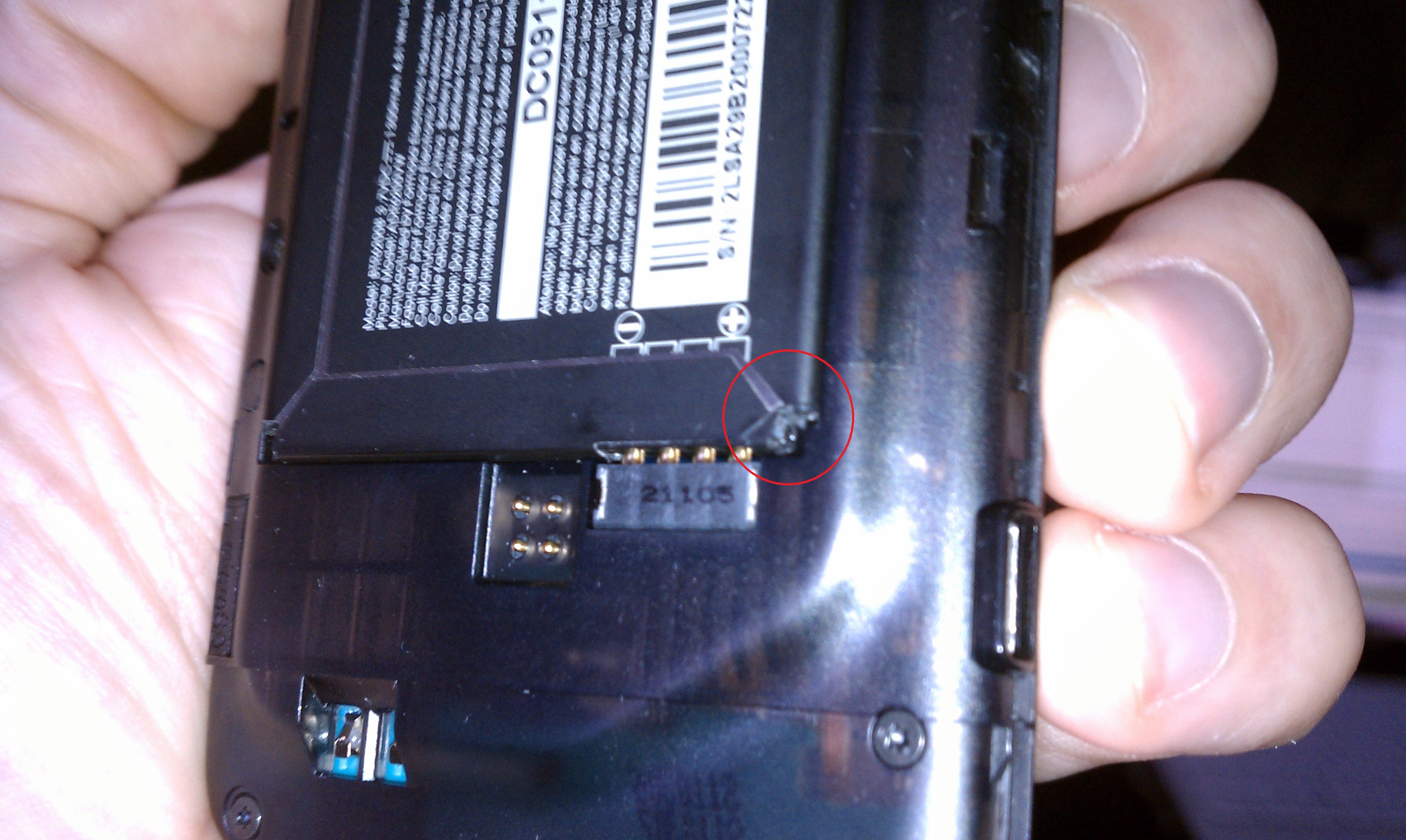

Just trim these tabs and make sure the batteries are not the touch pro 2 batteries and it will work upside down. obv it will be less than the standard 1450 that comes with the inc2. I have tested both the incredible standard and the eris standard both work.

here is a pic of my eris battery working fine.
the red circle is where i snipped it.

Well FML, carefully snipped one of my 'bidallies' 1500s and though it fit ok, The battery indicator showed a "!" ... so I am SOL it seems! Thanks anyway folks!
