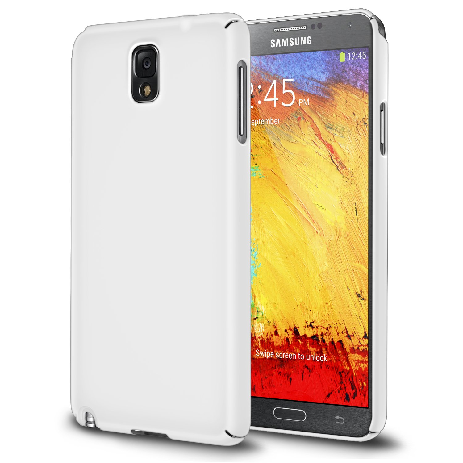

  • White eBay Qi-compatible charging receiver:
  • TYLT Vu wireless charging cradle:
  • Ringke Slim Case:
