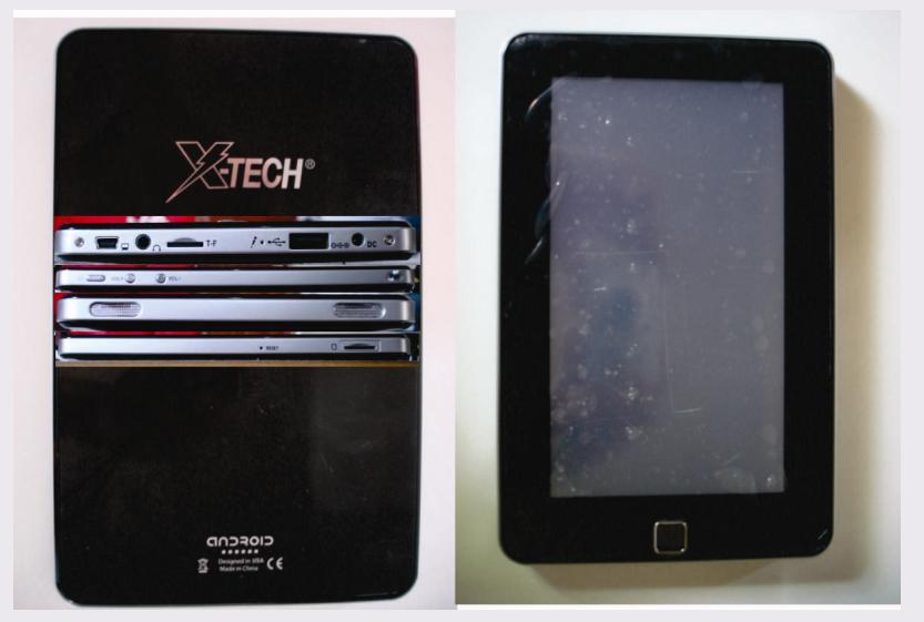

and my tablet is green led, red when charge, black phone connector.
help:confused:
