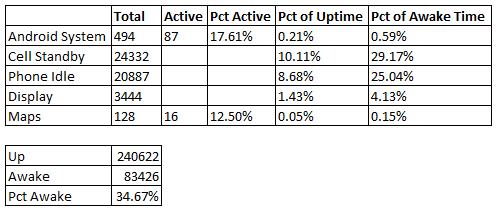

Here is what I am seeing on my phone (All times in seconds). Not sure if it helps much.
