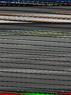

Hi guys,
I have just upgrade my x10 mini pro from donuts to eclair.
the drocap screen capture was works flawlesly before on donuts, but after upgrade to eclair, everytime i capture the result is a damage image. Looks like a screen resolution not match or sumptin, and this is happened on all kind of screen capture such as shootme and picme.
I would appreciate much if someone can help me to fix this.
Thank you in advance

try using adb for screenshots.
i use droid explorer on pc...there's a screenshot and even a screencast available.
cheers!
cheers!
what adb command to capture the screen ? link please if u don't mind.
thank you for droid explorer but i don't have winblows.
cheers

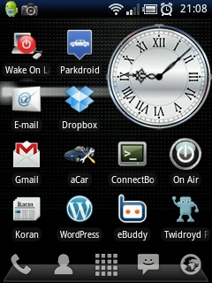

Fixed by drocap2 update from market today ... wooohoooo :)
Problem solved !
