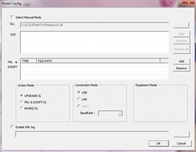

So I get to the screen pictured below, where I need to select the dll file, and it tells me wrong dll. I can't continue, and I can't root. What am I doing wrong?

Megalock.dll is just the license file for the lg flashtook program so don't try to load it.
You need to check the manual mode box and then click the little box to right of dll field. Look for a dll file that starts with LS740. Then click the add button beside the S/W field and select the tot file you downloaded. Then select Board DL in tge Action Mode field.

That's what I tried to do, I downloaded the dll that was linked by asmugone but it said wrong dll. I will try alternate download, maybe that will help
Bro you need to link the dll file to the one in the flash tool zip named LGLS740_20140414_LGFLASHv160.dll then link s/w to LS740ZV3_17.33030_Secure.tot
i posted a screen shot how it should look
let me know if you need anymore help
