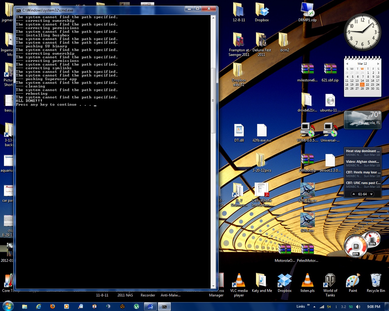

Dang, tried it in charge only mode but still get the multiple wrong path errors. I am trying to post a screen shot of what the errors are..
Ok, maybe this will work.. here is a screen shot jpg.

Well, this thing is kicking my tail.. time for bed.. lol I wiped the phone through the recovery, sbf'd back to 621... immediatley shut it down, rebooted bootloader and sbf'd 604. I do notice it changes from 2.3.4 to version 2.3.5 once it is a milestone.. Is that right? Why would the newer 621 be version 2.3.4 and the older 604 be 2.3.5? Either way, if thats susposed to be like that, then I am stumped.. I tried to re run the DoomLord zip that came with the sbf download by clicking on therunme.bat... it keeps giving me that error I posted... even tried it on a different pc..... is anyone else having luck with the rooting part? I am sure I'm following the directions... Is there any way (VooDoo) that you could put the actual zerg file you used? I have downloaded it a few times.. not sure if maybe its messed up somehow... I was really hoping to be back on my r2d2 rom tonight.. :(
Still a no go.... same errors. Has this been successful for anyone else? I haven't really seen any "success" threads.. :( just won't take the root. Using the one downloaded called DooMLoRD v4...I tried wiping several times, then went to 621, restarted it, loaded google account, let it chill for a bit, the flashed 604... tried to immediatley root and the same results.. nothing.
Still getting the same errors even after a few wipes. Wiped it multiple times, went to 621, all good there, went to 604, all good there, but the DooMLoRD v4 is not rooting my device. Is it possible that some may work and others won't? Just has me baffled. Would flashing from a "live" usb not be as good as flashing from an installed copy of Ubunto? Seems to work fine from the usb... but when I go into windows to do the root, no dice..what am I missing?

Oh ok, my bad.. I just realized the title of this thread sounds like I am using the APK through the phone, which I did try, but it get half way then botches up the phone, needing a sbf. Only tried that a few times, but didn't want folks to think it was because of the APK. I have been trying it through the DoomLoRd v4 root that came in the zip. Has the method layed out worked for you?

OMG, I'm such an idiot.... Unzipping the file worked.... I was trying to run it from inside the zip... lol u can just delete the whole post..lol unless others can learn from my mistake... thanks a bunch for putting up w me..
