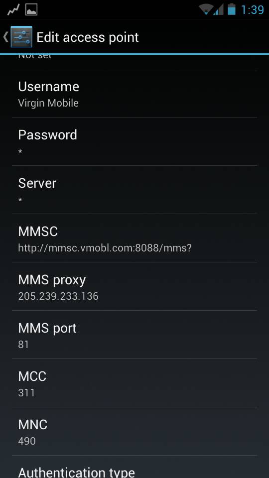

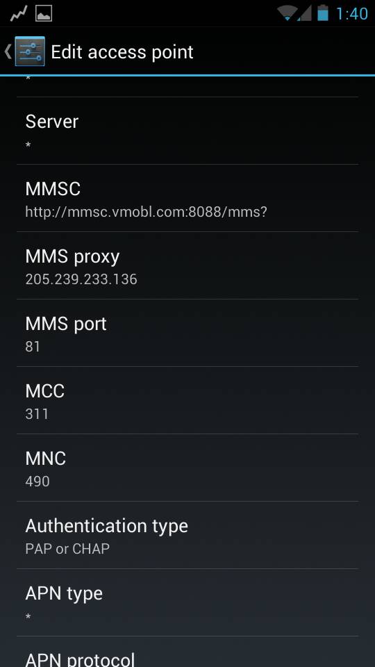

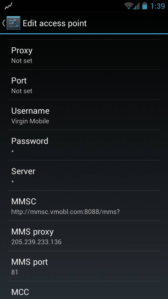

That's not what i have after flashing the vmd710
Attached in pic is what i got & mms works

Also wanted to add i still had to open voice dialer saying open Apns & select the bubble that wasn't highlighted selected after flashing and highlight the bubble
