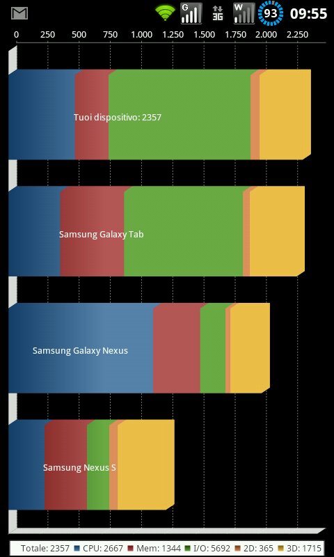

I tryied a new kernel with the cpu speed increased to 1.4GHz ...
This is the result of quandrant of this morning .

I have now tested the "chinese" OC roms (mentioned above) for a few days. Version 1 was blazing fast, but battery life not to good, also had a few reboots/freeze ups.
Version 2 have a lower Qudrant score of about 2.200, but also here I experienced some instability.
Now I am back on Catty's version 1.5.1 with the OC kernal.
