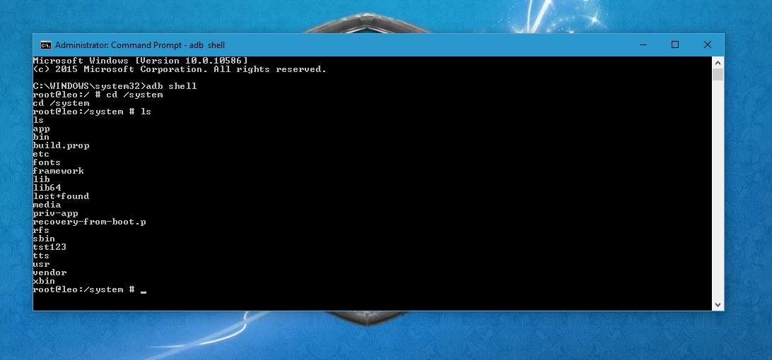

how are you trying to create the folder
this removes write protection
but you still have to remount the partition as rw
adb shell
su
mount -o rw,remount,rw /system
cd /system
mkdir tst123
ls

Did what you post and I could create the folder but when I rebooted /system is read only again.more details
adb shell
su
cd /system
mkdir tst123
ls
system will always need to be re-mounted as r/w after reboot
you can use a file manager that supports root access like EFS file explorer
make sure you set it to root access[/
