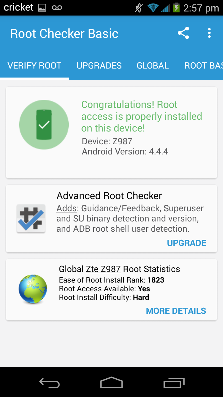

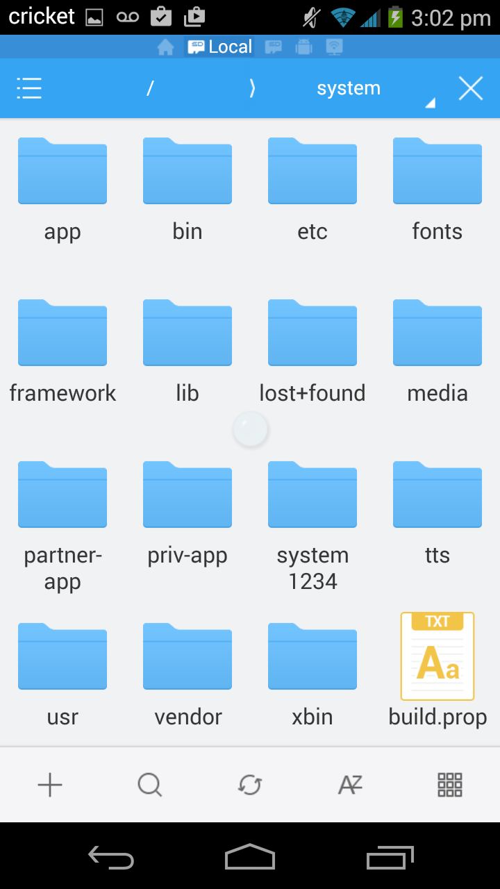

Did it work am I rooted? Do I have rw?.

Finally rooted .... this is the only problem I can see that I'm having ........... i would like a different rom like broken...

system will always need to be re-mounted as r/w after reboot
you can use a file manager that supports root access like EFS file explorer
make sure you set it to root access
So if u have root set in ES File Explorer then u don't have to remount the partition everytime right?? Thanks in advance.
